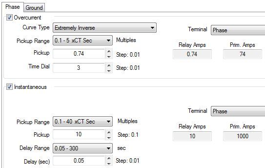

What is a setting for overcurrent?
RE: Io Residual current in protection relay settings
The overcurrent settings are found in the picture below. The CT ratio used is 100/1
The PU provided in the image above is not correct because the CT ratio that was set into the relay is 100/1 which should be 50/1. That is the first thing I have noticed when the settings were downloaded from the relay.
