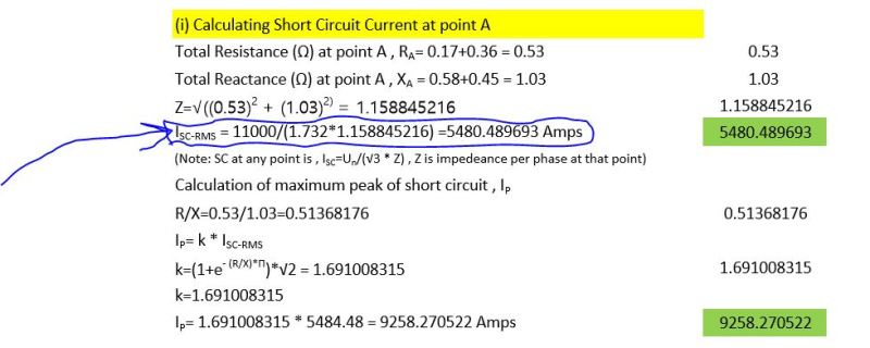

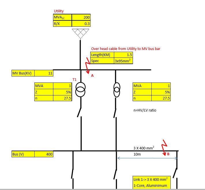

Hi !!
I will explain in a reverse way , by taking an example . Just ignore the material which is not relevant to you .
Suppose you have to calculate the 3 phase short circuit at point A as shown below .
As shown in blue is how we calculated the short circuit current , but in your case you already know the SC current , thus
Z = Un/(1.732*Isc).
Once you have Z , then you can calculate , R/Z=Cos(theta)
As you said you already have theta.
I hope this will help.
