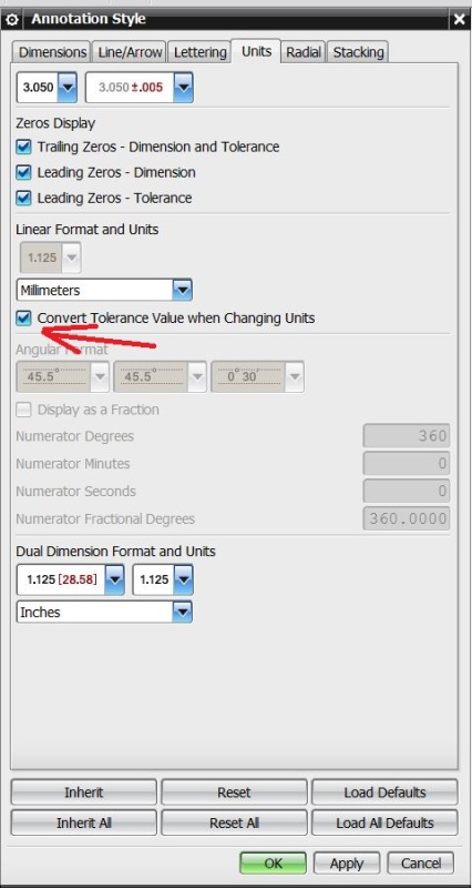

We design in inch but have to (unfortunately) put dual dimensions with tolerance on the print
When I activate the dual it has 2 boxes for tolerance (plus and minus)
whatever you put in here shows up when you add the dual
Is there a way to make the tolerance update when you change the main inch tolerance on the print
Thanks,

Dimension settings -> tolerance -> display and units, turn on the "convert tolerance when changing units" option.

Mine converts just fine when using dual dimensioning
RE: dual tolerance
Awesome thanks, mine was not checked
