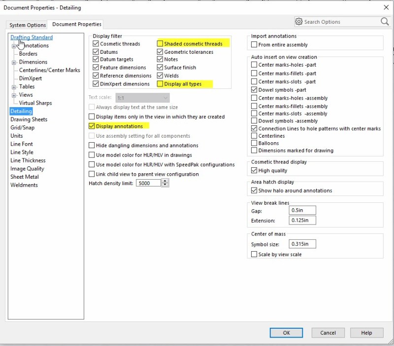

When I save a SolidWorks drawing as a dwg file all Toolbox Threaded holes lose their hidden circle and look like a thru hole. Anybody know why this happens? or if there is a fix for this?

Are you using the DWG mapping tool? I worked in AutoCAD exclusively for enough years that I developed my own standard, the way I like to do things. I was not at all happy with the results of a standard Solidworks conversion to DWG format. I set up a mapping file that directs all selected Solidworks entity types to particular AutoCAD layers, colors, linetypes, etc. All my DWG conversions go through that mapping routine. I just tried one, and the cosmetic threads come through exactly the way the mapping file says they should. Maybe the default is that if they aren't specifically mapped, they don't come through at all.

I created a mapping file as jboggs suggested and I have all of the drawing elements mapping properly to AutoCad except for the darn cosmetic threaded hole. I get the thru hole, but the hidden geometry circle just doesn't come in. I've tried setting the mapped line style to Visible Edges, Hidden edges, By Layer, but they just don't show up in the dwg file. does anybody have a successful mapped file for cosmetic threads?

Tom,
look at the attached files particularly:
"bob Mapped Cosmetic Thread Test - Sheet1--2016-09-15 09_52.jpg"
I think you need to display annotations
not sure if you need to uncheck the shaded cosmetic threads box or not
The above is in your SLDDRW file properties
Also look at my map file:
"bob ACADMap 04-21-16"
See the ZIP file:
"bob_Mapped_Cosmetic_Thread_Test.zip"
