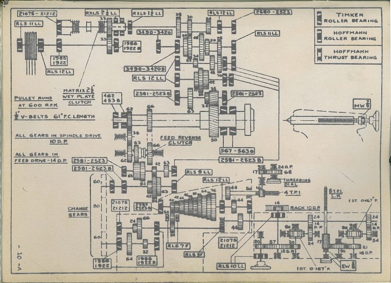

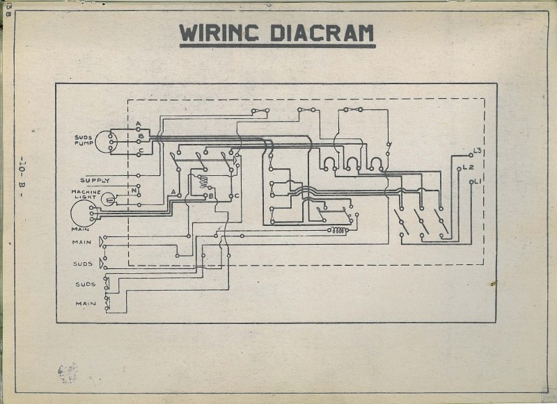

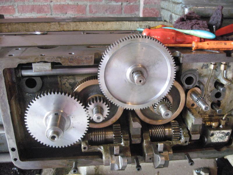

As we seem to be posting restoration projects lately, here's one of mine which I'm having an on-off relationship with:
An old Holbrook toolroom lathe from the 1940s, it weighs in at 2¼ tonnes for a 13" x 30" machine which is unheard of today for a manual lathe. A little worn in places but I have quite a few spares from a donor machine. Some of the pics are from when it first moved into its new home - it's now off the rollers and running from a 15kW variable speed drive which someone sold on ebay as a 'power supply' for little more than the postage. smile
I don't spend as much time on it as I would like, but so far I've enjoyed having it.

Those diagrams are the essence of completeness and clarity, too.

Yes, it's a lovely machine to work on with a lot of features which must have cost a fortune to provide. I'd had it a few months before I found some of them. It makes the Harrisons and Colchesters seem agricultural. I nearly ended up with a CVA but the Holbrook was a third of the price and could take bigger work. If the opportunity arose I would love to have one of the Holbrook Model H machines from the late 1960s which are rare and expensive, and still very sought-after today.
Sparweb,
I think it has had a few owners in its seventy-odd years, some more careful than others. The saddle was full of rusty sludge from old coolant and swarf, and the little reciprocating pump which feeds the oil galleries in the head was knackered so the gears must have run nearly dry, but they're very hard and massively oversized so they seem to have survived reasonably well. The rack for the saddle handwheel pinion is worn and a replacement is going to be costly, but I have a complete spare saddle / cross-slide / topslide assembly, a leadscrew, and most of the gearing from the head. I've got the whole manual and although only a dozen pages it is full of practical information.
