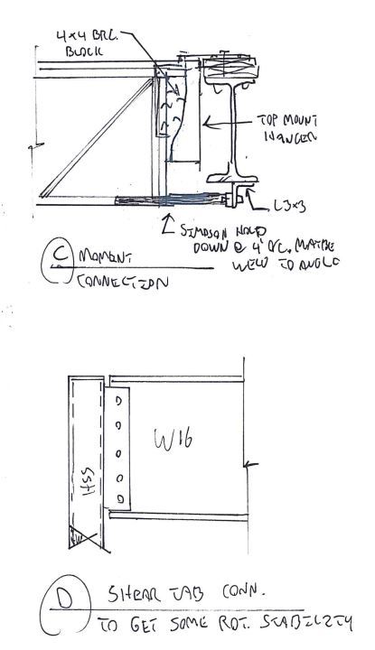

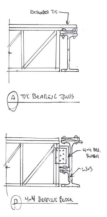

Here are a few options to help mitigate the torsion problem. My preference would be A + D. That's simple enough that somebody might actually do it as specified. You contractor will, of course, object to the lack of field adjustability in the HSS.

Koot's A detail may help mitigate any cold transfer issues if this is an exterior wall support.

Detail A is my go to detail when supporting parallel chord wood trusses on steel beams.
RE: I have a situation where the floor
Detail A looks good to me also, the only problem is the beam size is the same as the truss. Do I really need a 16" beam or can I use a shorter, heavier beam?
