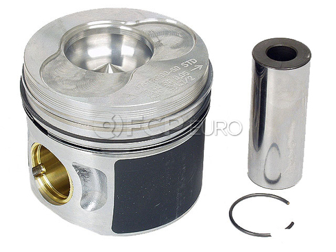

Interested in the opinion of others as to the practically, and suitable materials, for the manufacture of bushes to be inserted into a piston pin boss to allow use of a smaller piston pin. Hoping to adapt a piston with 16mm pin to a crankshaft with 14mm pins. Initially thought bronze to be a suitable material, but is steel an option.

Some trucks used to have bushed pistons. Maybe they still do.
Looks like VW deezuls did as recently as 2004. Looks bronze-y, but there are dozens of flavors of bronze.
https://dyw03owr7vs3n.cloudfront.net/public/assets....
I think some efforts to bush high performance Corvair car pistons didn't work out well. I believe differences in thermal expansion and heat transfer from piston to bushing were suspected as issues.
http://www.speedtalk.com/forum/viewtopic.php?p=895...
Have you investigated modifying the con rod for the larger pin? That gives you the option of equalizing the rod length, and creating a straight rod without resorting to bending the conrod to correct misalignment.
