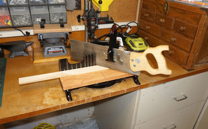

Well, I've finally finished my miter-box project. It took longer than I had expected, not because of any problems but simply because we've been busy the last few weeks and I managed to just put that finishing touches on it this morning.
Here's some shots showing the finished project:
I followed a similar process that I did with my previous sewing machine project where I first stripped off the old paint, cleaned the metal parts and painted the iron pieces first with a couple of coats of primer, then a couple of coats of Dupli-Color black enamel and after repainting the lettering I applied two coats of Dupli-Color Clearcoat. The original wooden platform looked like it was Redwood but I decided to go with something a bit harder, in this case a nice clear piece of Maple. I gave it a couple of coats of light Maple stain and then a couple of coats of clear matte finish urethane.
And here's the miter-box in working mode (as noted previously, my 'back-saw' is not quite of the same era):
I have one last step to take and that's to mount the miter-box on a scrape of lumber that when I need to use it, I can just hold it in place with a couple of C-Clamps as I don't have enough workbench space to permanently mount it as it was intended to be used.
