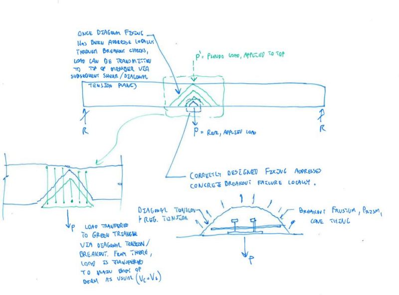

Quote (StrEng007)
Similar to the combined effects of ΦVc and ΦVs for shear in beams, can you rationalize a combination of ΦVcbg (shear breakout) and ΦVn (shear reinforcing)? Does ΦVn have to take 100% of the load if present?
This is something that I've wondered a lot about by myself. I don't have a definitive answer but, rather, some thoughts to share:
1) I've posed a similar question here my self. See this thread:Other Thread. The clip below is from it.
2) I know lots of folks do take Vs + Vc in these situations. I've done it myself in the past.
3) I don't currently take Vc in addition to Vs. I've come to believe that there's something fundamentally different about shear and tensile anchorage applications. Clearly, when you grab the entire concrete section, it's conventional shear. And if anchorage provisions are to be believed then, when you only grab a little chunk of the section, it's not conventional shear. Where in between those two extremes doe it switch over? I don't know.
4) Frankly, I've never seen a justification for why it is that we can add Vc to Vs in normal beam applications. Mobilizing Vs implies that the shear crack has already formed so I would have thought that it would be Vc OR Vs. The best rationalization that I can come up with is that, so long as the shear crack is kept small, the Vc capacity must be maintained post-shear cracking. That and the fact that some mechanisms are independent of the cracking (dowel, friction across the compression block...). This thinking is a big part of why I don't include Vc for intermediate situations any more. I feel that, without definite moment reinforcement to keep cracks small and develop the friction mechanism, it may not be valid to count on Vc.
