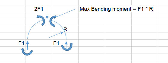

How would you analyze the local stresses in this arrangement (sketch attached

BS5500 PD5500 has charts and formulas for local loading on shells. These may cover your geometry.

Kevin, PD5500 Annex G looked very promising; however, my application does not meet the geometric restrictions for L, r, Cx, and Cphi.

Not a simple problem, that's why no simple treatment of it can be found in the literature. The closest similarity that I can propose is with saddle supports: here many papers exist (and also PD5500 has it), but generally the included angle is less than 180 deg and the saddle flexibility is far from being constant. This paper has a single case where the saddle angle is 180 deg.

Kevin, Prex, thanks your time. This does appear to be a somewhat difficult case to analyze. I have been reviewing saddle support documents (Zick's and Roark's). I'll take a look at the paper you posted too, Prex.

Conservatively and easily you could consider the clamp as a point load on the shell and calculate the maximum bending moment in the shell. You could also consider a local bearing load stress at the point of contact of the point load on the shell.
