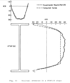

Already suggested the built-up plates, and they believe that it is just as costly as the cut W24. I wasn't too concerned about residual stress, as I figured that they wouldn't be much more than those resulting from rapidly cooled hot-rolled steel. I am thinking about increasing the inside radii to 1-1/2", re-checking the weak axis moment, and calling it a day.
http://preserve.lehigh.edu/cgi/viewcontent.cgi?art...
