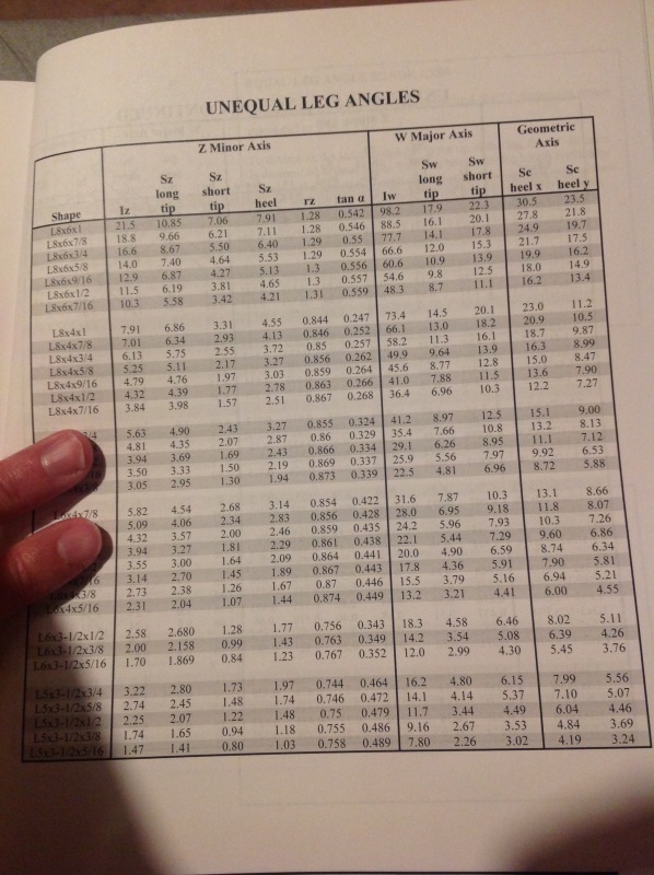

I have a structural steel textbook with one example for calculating the stresses in a single angle subject to flexure. I have about 75% of the information I need to understand the concept completely. I understand that you have to calculate the product of inertia in order to properly calculate stresses. Does anyone know of a good reference for clearly explaining how to calculate the product of inertia of a single angle with the leg in compression and tension?
All of this is before I even begin to tackle the AISC method of calculating allowable stresses.

Yes Hibbeler has an explanation of it. I was looking for more examples of how to do it. If I take what Hibbeler does and apply it to a single angle I have no way of knowing if I am doing it correctly which is why I was looking for another example.

I've got a copy of this which has some examples: Link. Unfortunately, you can't buy a digital copy and have it in hand right away.
RE: Single Angle Stress Calculation
AISC's design examples are available too. Though, you don't need them for calculating rx unless you have a custom shape. rx along with the other principal axis geometric properties is tabulated in the steel manual.

The book that I mentioned tabulates some sectional data that you may be able to check against. An excerpt is shown below.
