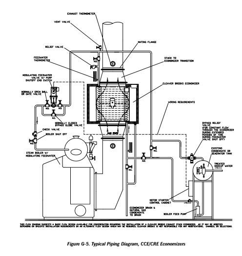

Yes. We have an economizer installed at the stack.
and since we have touched the point, may I know what is the typical exhaust gas after the economizer if we are running on natural gas.
I have seen the temperature after exhaust reached 90 deg C which I am sceptical because based on the boiler performance data, the lowest is 116 deg C.

After some research, we don't think we will recover the condensate but we would put a heat exchanger to recover the heat to heat up our makeup water before going to the deaerator.
lilliput1 - you mentioned about temperature limitation on the economizer outlet. How low can the exhaust temperature be before it starts to condense?

Package economizers are designed for about 300F leaving exhaust gas temperature. See attached. Note recommended economizer piping to always have water flow in the economizer to prevent water from boiling in the economizer tubes.
Consider economics (unless Owner wants to get more LEED points). How often is autoclave used. How much steam. Cost of heat exchanger (double sheet to safeguard against contamination) plus pit mounted condensate pump.
