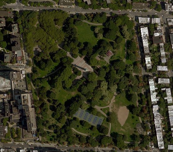

Way back in high school I took a surveying course - 6 hours per week for two terms. The culmination of our class work: Everyone had to draw a detailed topo map of a 35 acre park next to the school.
