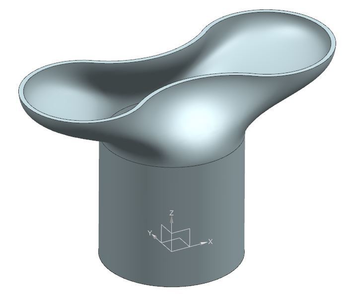

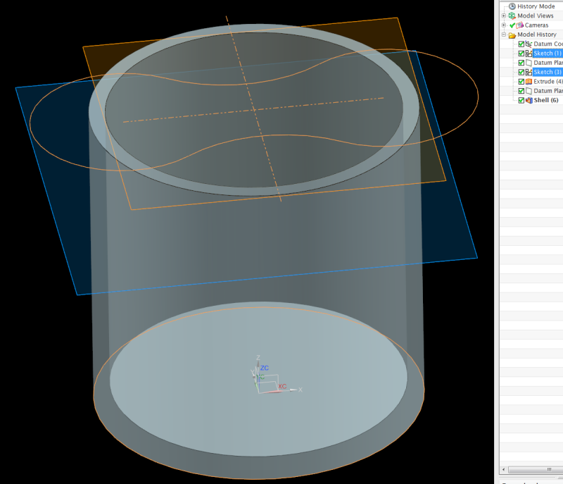

So I played around with Global Shaping and it seems to be exactly what I'm looking for, but I can't seem to find a tutorial to get it to do quite what I'm looking for. If anyone has experience with Global Shaping and can point me in the right direction, I'd greatly appreciate it.
If you look below, you can see a greatly simplified example of what I'd like to do. I have a circular, shelled solid, that I want to transition into the sketch on top at about 80% of the solids height which is represented by the blue datum plane. It looks like "To Curves" type is what I should be using judging by the icon but can't figure out how to use it without getting errors.
RE: Arbitrarily deform/bend/scale geometry of parametric model?
Or if it works better with the tool, not even transitioning into a sketch. Just "denting" the solid body at the top-center would do exactly what I need it to as well I'd assume.
That can be done with Global Shaping. I did the example with By Surface option. The problem is though that what works with this greatly simplified model might not work with the actual model at all. Although I think that By Surface is the way to go with that model too.
You said that the model was something like a laundry basket. If you use the By Surface option I would create a very simple surface that resembles the actual basket model. Then from that surface I'd create the morphed model, using X-Form or something like that. Then you can morph the actual solid model using the simplified surface model as the base and the morphed surface model as the control surface.
There might be an easier or better way for this but that's one way I would try doing it. If you can provide a simplified version of the real model that would help a lot. In case you need more assistance.
