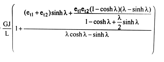

Here's the method:
You'd need to do a 3D stiffness matrix, having 6 DOFs at each of the two nodes. By symmetry you could do 6 DOFs.
I'm assuming you know how to get shear, flexural, and axial stiffnesses.
Torsional stiffness is GJ/L if torsionally pinned (warping is unrestrained).
If warping is restrained, torsional stiffness is:
et1 and et2 are numbers from 0 to 1, 0 being a 100% warping unrestrained end connection and 1 being 100% restrained.
lambda is dimensionless: Length * sqrt(GJ/ECw)
