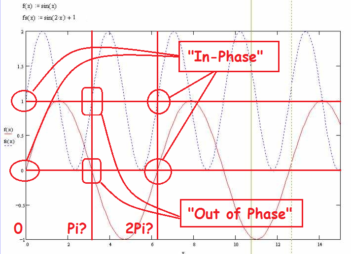

I have a sine wave plotted, i.e. y = sin(x)
I have a second wave plotted, where y = sin(2x)+1
I now wish to introduce a phase shift, such that the latter wave becomes tangential with the former.
Whether the shift is in the X+ or X- direction is irrelevant to me.
Can anyone please explain how to calculate this phase shift, and illustrate it with an Excel graph, to show that the results of the calculation actually do provide the correct phase shift to create the condition where the waves are actually tangential at certain periodic instants.

Apologies that my previous attempts went off on a tangent... Trying to understand the question is often where I get confused.
Let's try again.
For 2. y = sin(2x)+1, the +1 offset has zero effect on the slope, so the +1 can simply be dropped (ignored).
For any y = sin(...), the slope (or tangent) is the derivative, which is just y = cos(...).
This derivative of any sin being cos can be done practically by noting that sin and cos are exactly the same thing, with a horizontal relative 90° phase shift (the period of each signal).
The sin wave becomes its own slope by simply kicking it sideways by 90°.
Combining the two (eliminating the unnecessary +1 vertical offset and perhaps sliding each waveform horizontally each by their own 90° to each become their own derivative) then the two new curves will obviously cross where their slopes are equal.
This answers the question to know where the slopes of the original waveform are equal.
Measuring the relative 'phase' (*) at other points is a simple linear measurement (horizontally) with a ruler, to the nearest matching point (remember that amplitude = slope).
( * The vocabulary gets a bit twisted due to the point originally raised by Bill (waross). But I think that the last step here is obvious at this point.)
I hope this helps.

Quote:
Given two different signals, in order for the amplitudes to be equal, the waveforms must cross over. Obviously the slopes must be different at that same point !!
I'm not sure about the 2nd statement.
But more important I think the first statement is incorrect, and examining this behavior helps us graphically envisioning the solution to op's problem.
As a simple example look at two curves: cos(pi*t) and cos(2*pi*t)
Examine behavior at t=0.
They are not crossing over.
Both they have the same value (1) and the same slope (0).
It is similar situation for the op's problem. It is not a point of crossing but a point of contact/tangency between the two curves.
In the way it is plotted in original post the upper lobe of the lower curve intersets with the lower lobe of the upper graph at two points (roughly x=0.9 and x=2.8). If we slide the upper curve to the right gradually these twp points of intersection will move. If we slide far enough to the lower lobe will not contact the upper lobe at all and we have zero points of intersection.
Obviously somewhere between the two points of intersection and zero points of intersection, we have to pass through a place where there is only one point of intersection of the two curves. And if they do not cross but have one point of intersection, then we conclude that will be a point of tangency. I think you can apply similar logic in any region of two "smooth" curves where one is concave up and the other concave down.
Attached graph illustrates. Blue and red curves are the op's curves. Shift the Red curve to the right and it turns into the red curve and those two points of contact merge into one local point of contact (if you shifted any further they would turn into zero local points of contact).
(2B)+(2B)' ?
