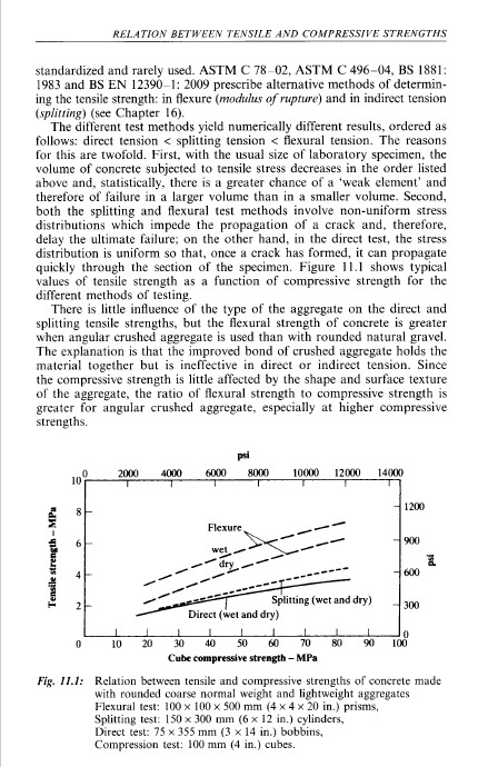

I suspect one reason why the pulloff tests are not comparable to the actual tensile strength is because they are typically done with a small (50mm) diameter disk which is cored into the substrate. Like Ron said, small diameter samples are more strongly influenced by minor flaws because they make up a greater proportion of the cross section. As well, the damaged surface area from the coring makes up a greater portion of the sample. You have more cut/disturbed aggregates which are no longer effective. Same principle applies for compression tests, which is why we use larger diameters for a more accurate measurement. You really can't compare this test to the actual tensile strength of the concrete. But you can use it to see where the weak link is: the new concrete, the old concrete, or the bond.
There is literature comparing the test results between direct tensile, splitting and MOR tests. I haven't read any, but my concrete textbooks do discuss this difference. It is established that MOR strength > splitting tension > direct tensile.

MOR strength > splitting tension > direct tensile. Sometimes the good old fashioned medium is the best! That is what I had thought when I started this string. Can you tell me the reference book that you found that in...maybe we have it in our office library. Is it Troxell & Davis?
From "Concrete Technology" by Neville & Brooks,
