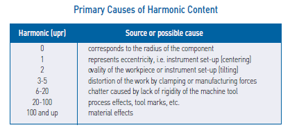

GregLocock-
Your post regarding ovality and harmonic analysis of radial profile shapes was helpful. I did some reading on the subject and learned that ovality describes a specific runout profile having 2 undulations (or lobes) per revolution (UPR). The harmonic characteristics of a runout profile, such as ovality, are often evidence of certain problems with the set-up/process used to manufacture a precision cylindrical part. Below is an interesting chart on the subject from this brochure:
