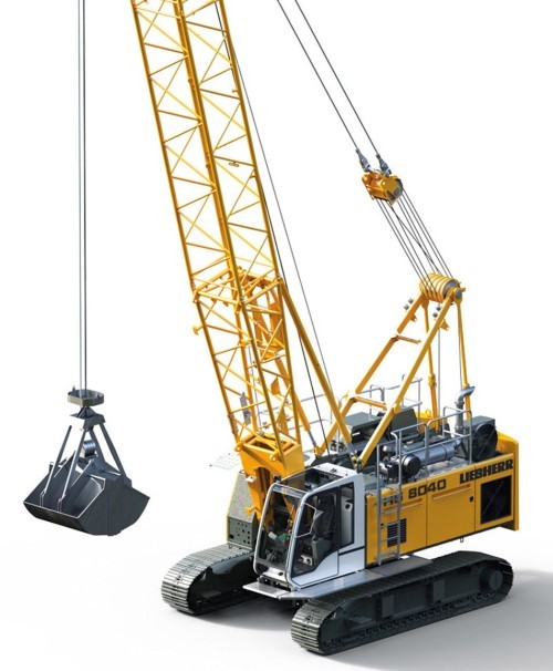

Excavation straight down is common in bridge construction. This is often performed with a crane using a "clamshell bucket", see the image below. A good crane operator can dig a surprisingly neat hole with a firm bottom. A foot, or so, of crushed stone at the bottom will provide a good working base. Twelve feet deep is not a big deal. Of course, as mentioned above, shoring will likely be needed. Depending of jobsite conditions, water table, and soils, a sloped excavation may be faster and/or more cost effective than shoring.
