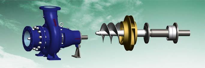

Your 50hp pump is running twisce as fast which is probably why it has a much higher NPSHr. It probably also means that it's cavitation start level is also higher than the 60hp pump which runs slower.
As Artisi says, other pump suppliers exist and may well have a pump more suited to your particular needs.
I will say that 84% efficieny is very high - if you could get the 50hp to work then it would be best, but the margins are too tight given that the inlet head is effectively fixed by the sound of it.
Have you asked the pump vendor if he can put an inlet screw (inducer) on the pump inlet to lower the NPSH? Often offered as an option if you ask.
Like this.
