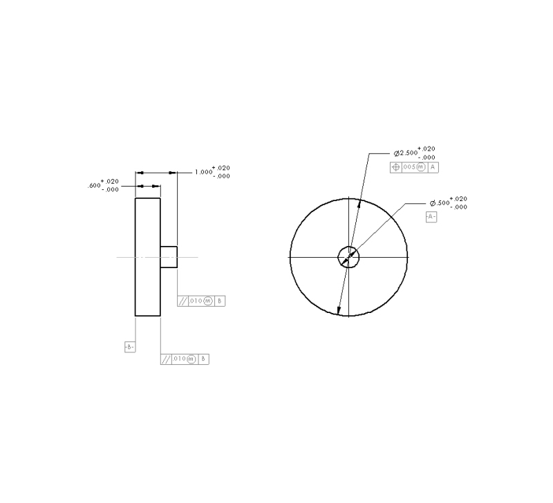

Are the parallelism calouts correct in Y14.5? Also how to inspect these orientation callouts at MMC?

No, they are not correct.
Parallelism as surface control is not using L or M modifiers.
To control parallelism of derived middle plane,
a) controls must be attached to appropriate FOS dimensions.
b) FOS must look like FOS (it may be argued if 1.000 dimension represents FOS of not).
So, better job could be done to control parallelism of these particular features.
RE: Correct or not? And how to inspect?
So, if they are using DMP flatness-DMPF- (as they should) how the DMPF will control the surface parallelism?
I know that flatness will control DMPF, but what about the parallelism? How to relate DMPF with the required parallelism?
My assessment:
You derive the median plane from the surface, there is no way that the DMP flatness could ever be greater than the surface flatness.
* flatness controls DMP (derived median plane) flatness, but DMP flatness does not control surface flatness. As long as the out-of-flatness of the surface is symmetrical, the DMP stays flat.
* specifying DMP flatness, the value in the feature control frame can be less than, equal to, or greater than the total size tolerance -- whatever is functional.
@greenimi:
I think you are comparing apples to oranges here.
Flatness cannot control parallelism. There is no relation.
Maybe you could chose different wording for your question, or, better yet, provide a little sketch.
Right now it's a bit confusing.
Based on this very old picture, http://files.engineering.com/download.aspx?folder=...
And providing that Rule 1 is in action, you could shrink size tolerance until both flatness and parallelism satisfy your demand.
Unless you are trying to ask something else?

Try to visualize something that is flat, but not parallel to anything.
And no,flatness will not control parallelism.

Once again, no

Quote (CH)
Only size tolerance will control parallelism
Only if Rule#1 is in effect.
If rule#1 is not (since in my example I have added DMLF) then how is the parallelism controlled direct or indirect?
That is my dilemma.
I think that flatness of the derived median plane idea was offered in case the max. material modifier in the geometric tolerance window was thought necessary for the design intent of the part. I believe that the quickest way to check the flatness of DMP (at circle M) is with a full form functional gauge (bridge gauge). With the .500 dia. protrusion on the top of the part this inspection might get slightly more costly. It also should be noted that rule #1 does not apply to FDMP.
