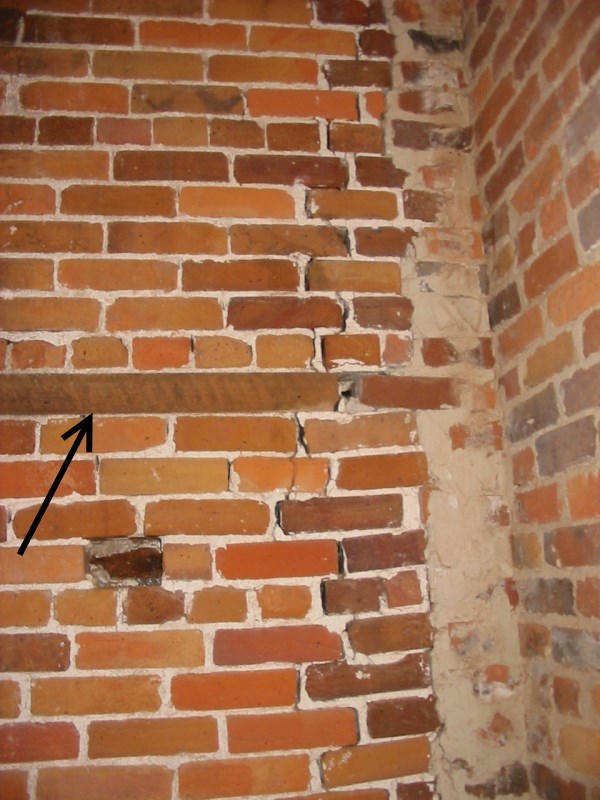

Hi Everyone,
I am currently working on a project in the Chesapeake area that has timber pieces built into its masonry walls(See attached photos). The timber members run horizontally in different places and are located on the first and second floor at different heights but are continuous. They are not nailers and run completely through the 2-3 wythe walls. Has any one run into this type of masonry wall construction and if so, where? Thank you!

Your photos are not attached, but what you are describing sounds like a variation of "half-timbered framing". That has been around since at least the Middle Ages.

As SRE notes, it may be a normal timber framed home with masonry infill between the timber members... In early England, many buildings were timber framed, but used wattle and daub infill.

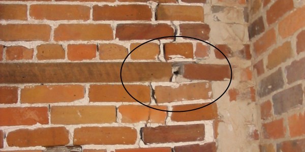

I am aware of half timbering but I think it is something else? Maybe it is a variation? Have any of you run into a home that looks like this and if so would you mind sharing the date and location? See attached photo.

That is one ugly looking corner joint. Maybe it was someone's take at half-timbered. Those brick walls don't look great for load bearing capability.

A few years ago, I did come across a modest version of what your photos shows in a heavily-built c. 1880 waterfront warehouse in Georgetown, SC. The client needed a timely evaluation of the building's condition (he had to make a purchase decision 8 hours after contacting me). The vertical crack visible in the photo below is from the 1886 Charleston earthquake.
Brick infill was common in the 18th and 19th century. From the appearance of your bricks, I'd say that building is from the 18th century.

Would the timbers be an effort at reinforcing, like "bond beams"? Or maybe just nailers to aid in hanging pictures, attaching cornice, etc. They didn't have all the masonry drills and different types of anchors we have now, so a lump of timber in the wall would be handy.

Hokie - I believe you may be right about an attempt at a wooden bond beam. Even looks like if the timber I saw had been continuous it may have successfully resisted the vertical earthquake crack. At Georgetown the 1886 earthquake had an estimated intensity of Modified Mercalli VIII (Magnitude 5.8 +)

Yes, the plan just said to put it in, not to splice it at the ends of the pieces.
RE: Wood Timber pieces throughout historic mansion in place of masonry?
Is that supposed to be a running bond in the corner? Looks more like a "falling" bond pattern. Based on the similarities in the photos posted by two different engineers, is it possible that this practice was the "norm" during the time period?
looked like it was just fill in, then differential movement fractured some of the bricks
