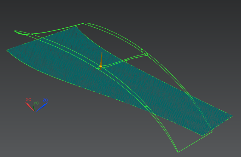

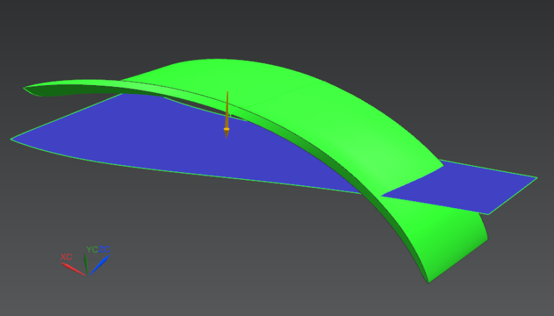

Is it the result similar to what you need?

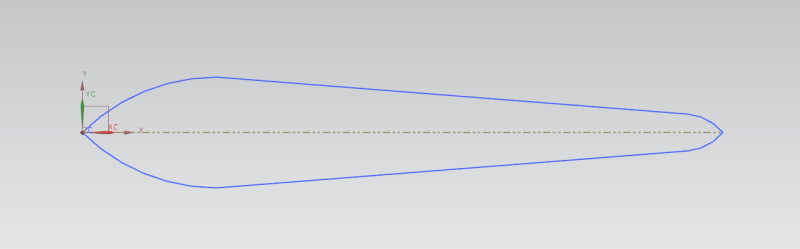

The pic below is a sample of the cross section that I am trying achieve.
