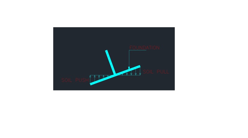

It seems that the formula be derived per the assumption that soil can apply both "push" and "pull" pressure on the foundation.
Assume foundation LxB, soil sub-grade modulus K, foundation rotate "A" under moment "M".
Maximum linear compressive pressure 1/2xL/2xAxKxB
Resultant of the compressive force on foundation 1/2x(1/2xL/2xAxKxB)xL/2=1/8xL^2xAxKxB
Moment to the foundation center due to compressive force (1/8xL^2xAxKxB)x2/3x(L/2)=1/24xBxL^3*KxA
The rotation stiffness of the half foundation 1/2xIxK. The soil can "pull" the foundation then the rotation stiffness is IxK.
My question is: Is the assumption acceptable?

RE: Modelling Footings using Springs
JasonMcKee71.
I agree that the foundation should be treated as rigid. My point is that the foundation rotation stiffness is derived per the assumption that the soil can both "push" and "pull" the foundation when it rotates, as shown in the picture. My previous post showed how to derived the foundation rotation stiffness per the assumption.
The reality is that the soil can only "push" the foundation when the foundation moves toward the soil, and the soil has no restraints on the foundation when the foundation moves away from the soil. Therefore, the rotation stiffness derived per the assumption may be not appropriate.
