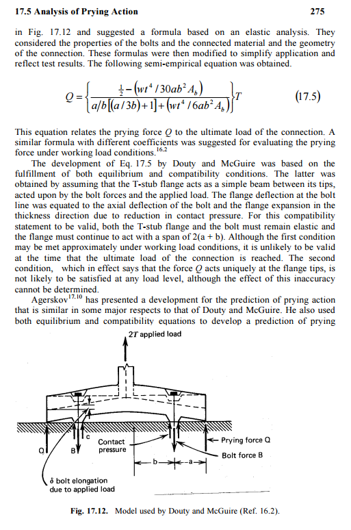

Hello All,
I need to analyze 2L-4x4x1/4 (attached) that will be used to lift concrete pieces during a bridge demolition. I wanted to use table 15-2b of the 14th edition steel construction manual, but it only has 5/16" thick flanges and larger. I purchased "Procedure for Design and Analysis of Hanger-type Connections" from AISC and it has greatly simplified simplified pgs. 9-10 - 9-13 of the 14th edition steel construction manual. Per the reference, I have calculated the allowable tension per bolt based on three failure modes, plate failure, bolt failure with prying action, and bolt failure without prying action. As I suspected, with only 1/4" flanges, the plate failure mode governs. I am not very competent when it comes to the effects of prying action. How do I calculate my actual applied bolt tension? Are there any additional references I should be using? I also attached a beam model of the flange from the reference that I purchased.
Thanks!

You may find this free resource helpful: Link. I believe it's the source document for the AISC stuff anyhow. You'll work out your bolt forces based on a model like the one shown below.

I'm not familiar with that hanger reference (or what KootK posted), but in the AISC 9-10 method, the actual tension on the bolt is T+q.
