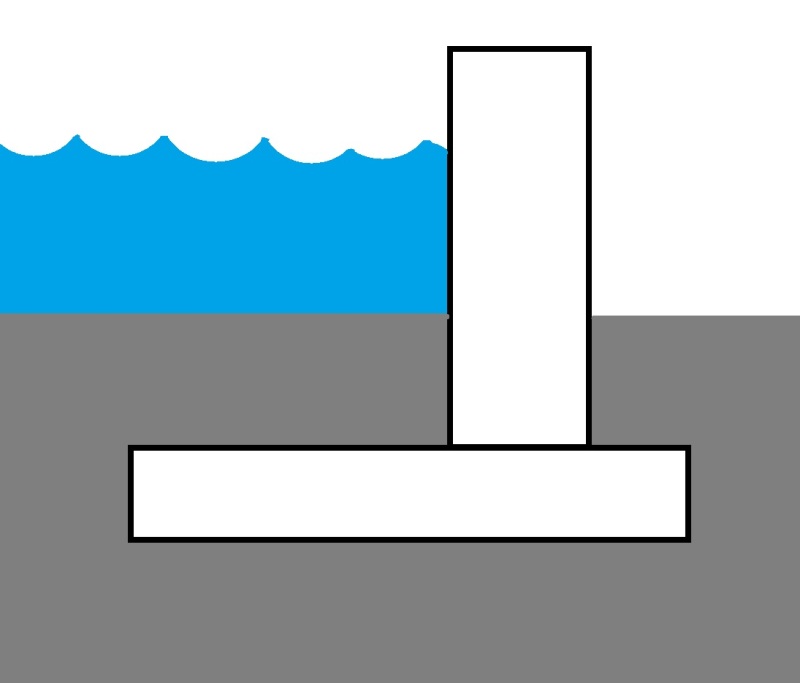

At first when I did the overturning calculation and the sliding calculation, I added the weight of the water above the heel like if I was designing it to retain soil. But the more I think about it, I feel like I should not. If I do not add the weight of the water, it seems impossible to do this. Basically we want to build a secondary containment at a chemical plant. We want to build a wall around a large tank to make sure we can contain the largest tank if it breaks. Do you think I can use the weight of water above the heel?

I think what precast78 is talking about is a perimeter retaining wall that encircles some separate tank that, if it spills, will help retain the liquid. Thus, the retaining wall is serving as an isolated, cantilevered stem wall on grade, totally unlike a tank...with not continuous base across the enclosed area. (Is that correct precast78?)
To answer the original question - I would say that you shouldn't rely on the liquid as some sort of vertical dead weight helping to hold down the heel of the retaining wall as liquids have no internal shear resistance. The liquid would simply move out of the way if the heel were to rise upward.

Yes, exactly what JAE said. It seems impossible to make it work with a precast. The liquid can go as high as 10 ft. I have to make the precast so big if I can't use the vertical load from water. The only way I can see we can do it is if they put soil on the other side almost all the way to the top of the wall. But they told us no soil on the other side.

I'm at a loss as to why we aren't including the water as a resisting load. Caveat being that appropriate load factors are used (ie the pressure causing overturning is factored as a load, the weight preventing overturning is factored as a resistance). A sketch might help.
RE: Retaining wall to retain liquid
I'm visualizing something like this. And water and soil directly over the footing would be included in the uplift resistance in that case.

I'm envisioning the upside-down "T" shaped retaining structure rotating about its toe due to the overturning of the water horizontal force.
If so, the heel of the retaining wall has weight on it from water, but once it rotates only a bit, you now have water under the heel too - thus a buoyant condition for your heel with the same pressure on both sides.
The water won't push down on the heel any more that the water below it pushes up (same water pressure at the same depth).
Think of a slab of concrete underwater. The only thing pushing down on it is the buoyant weight of the slab - not the water above it since there is similar water below it.
The water will simply flow out of the way of the heel which moves upward through the water.
Now if the heel had soil above it, that soil is interconnected to the surrounding soil with an internal shear stiffness/resistance. I think there's a big difference here between heel soil and heel water.
The sketch above by JStephen does show some soil on the back side. If there is full fluid coming to the wall above this soil, then conceivably that heel soil might become fully saturated and be a dead weight on the heel to some extent.
We've debated here in the past about how much soil can be counted on over tank footing extensions to counteract buoyancy uplift. The concern of taking a wedge of soil instead of only the soil directly above the footing extension is that the soil, being saturated, may become "mush" - i.e. the soil has lost its internal shear stiffness and only the soil directly above the lip will resist uplift.

Well, I guess I'm more or less on side with JAE, except if it's containment, is there not a liner preventing water from getting below the wall?
So if I use JStephen's sketch. Do I need to subtract any buoyancy force?
I'm not well versed in this kind of work. With these secondary containment systems, is the fluid not also "contained" from leaking into the ground? Or is is common to assume that system may fail as well? If the fluid can get under the footing then I'm also "on side" with JAE's position.
Ideally there is no seepage going under the foundation, but that is not real life. With seepage, you lose that benefit from above and seepage lifts.

If we are assuming that water finds its way below the foundation, then the coefficient of sliding friction goes way down. Its almost like a car's tires hydroplaning on a patch of wet pavement. Also, as the water seeps below the foundation, the driving force behind the wall decreases since the water level decreases due to the seepage.

I agree that unless you introduce soil and then a liner above it on the inside of the wall, with your upside down tee, then the basic answer to the original question is no.
Of course you could do that with something like the sketch by J Stephen or simply lay it on the ground and back fill from beyond the heel / T to the top of the wall at a suitable angle to provide your static load.
~This would also reduce any shock loading from a wall of liquid racing to ward the wall from a catastrophic collapse. It reduces the bund volume, but only by a small amount.
This is bund wall design of which there are many examples.

LittleInch, JStephen's sketch is accurate except the client wanted the precast piece sitting at grade (not possible). So I am proposing what JStephen sketched. It will be buried 6 to 7 ft.
