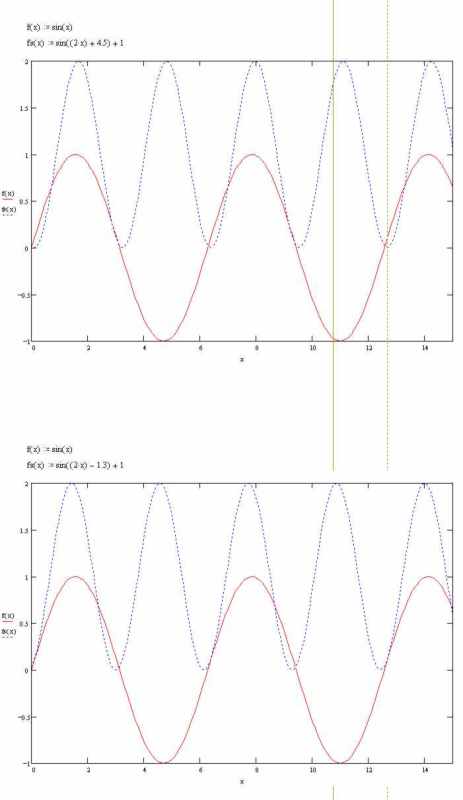

Well, here are two manually adjusted graphs.
First thing, I was wrong to assume -ve s and +ve s would give the same results.
I had to do a fudge of s = -ve 1.3 or s = +ve 4.5
@MacGuyver You can see in both these solutions that x and s are not a common value of opposite signs.
In the upper solution, when x is about 3, s is 4.5
and in the lower solution, when x is about 0.1, s is -1.3

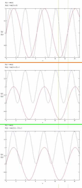

This is how I have broken it into separate stages, but I still don't know how to calculate the true value of s.
The first stage shows the two superimposed sine waves.
Stage two shifts the higher frequency wave upwards by a value of 1, hence the lowest point is tangential with the horizontal axis.
Stage three then slides the higher frequency wave horizontally until it becomes tangent with the lower frequency wave.
Common in the three plots is sin (x)
Then the superimposed wave is:
Plot one has sin(2x+0)
Plot two has sin(2x+0)+1
Plot three has sin(2x-1.3)+1

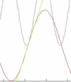

@MacGyverS2000 -- But the derivatives are the tangent points.
There's no need to plot them.
They're shown below by the estimated green line, representing the common tangent point.
