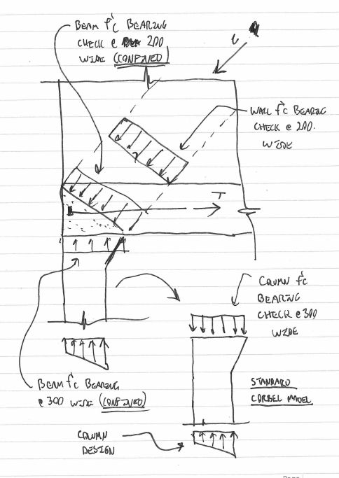

Hi All
I have a wall resting on columns.
The column has a column "head" that coincides
with the angle of the compression strut and also
have a slab thickening under die wall. (see attached sketch)
The bearing area is a bit of the issue. Do you take it as the
width of the compression strut mulitply the wall thickness or
can you use a bigger area ( picture under column) since
there is a slab thickener?

RE: Bearing Area Shear Wall on Column
Quote (SteynvW)
Do you take it as the width of the compression strut mulitply the wall thickness or can you use a bigger area ( picture under column) since there is a slab thickener?
For bearing on the wall side of the interfaces, you would use the thickness of the walls. For bearing on the beam side, you could probably use the same thickness but a higher f'c based on confinement. I've sketched up some thoughts below.
I question the efficacy of the corbel strategy. It will complicate formwork, work your columns pretty hard, and and may not alleviate all of your bearing issues. That said, I know that we've discussed alternate strategies at length in your previous, related threads. If you say the corbel's the way to go, then I'll do my best to help you get it sorted.
Hi Kookt
As always I appreciate your input (really enjoyed you rebar development around corners discussion, we also have provisions in our code for it). As far as the rest of the structure
goes almost everything else from beams to slabs to stairs and piles have
been completed, this is just the final puzzle to crack.
After some arguments with the Architect and the QS I have convinced them
to increase the thickness of the wall (more of a spacial than a cost issue)
but not enough to get the required area in my strut without sending reinforcing through the roof.
So if I cant have thickness I have to have width and with this corbel I can get the required width without hampering the the layout or the adjacent parking.
Quote (SteynvW)
Are you concerned about the eccentricity (hence a extra moment) it will create on your column?
Precisely. That said, if it works... it works. And reviewing your geometry, the eccentricity doesn't look that bad anyhow.
If one wished, another approach could be to treat the portion of the column with the corbel as an element cantilevering down from the wall above. Then a pin could be assumed at the bottom of the corbel and the column segment below assumed to have no load eccentricity. My guy tells me that might be closer to the truth of things given the relative stiffnesses of everything.
