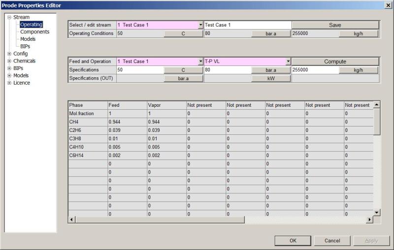

to give a idea of how to use the software, see the steps
define stream 1 with C1 0.944 C2 0.039 C3 0.01 NC4 0.005 NC6 0.002
P 80 Bar T 50 C Flow 255000 Kg/h (8MMCFDAY/0.77/24)

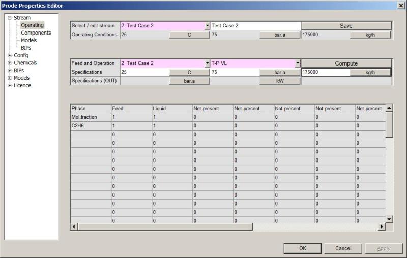

define stream 2 with C2 1.0
P 75 Bar T 25 C Flow 175000 Kg/h

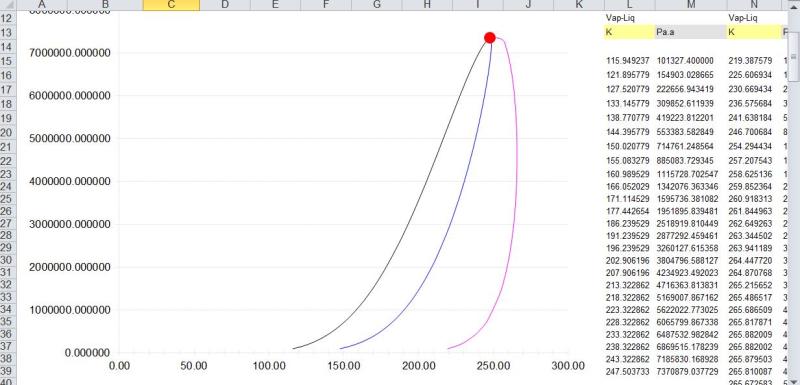

with Peng Robinson standard, the calculated temperature is about 14 C
for this stream the program calculates this phase diagram
given the same inputs (compositions, operating conditions, models) you should obtain similar results from your simulator...

I corrected the same. Precisely for this composition the density comes out to be 0.725. Using the same, I did rest of the work in DWSIM..the results are very much the same..mixture temp comes out to be 14 degC (presily as yours), also the mixture composition comes out to be C1 67% & C2 32% (presily as yours). Also the phase envelope derived from DWSIM is very much similar to that derived from Prode.
