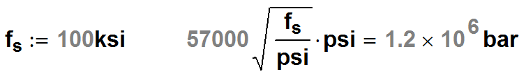

If I were to define fc := 4000psi
How would Mathcad perform the following function for the elastic modulus?:
57000(fc)^0.5
I know Mathcad is smart in terms of performing unit conversions seamlessly, but what about equations where a specific unit is required to obtain a desired result? Is there a way to "hardset" the input unit? Also, is there a way to "hardset" the output unit for empirical equations where the output units don't necessarily equal the input units (such as the formula for the elastic modulus)? Or would I need to apply a unit to the constant portion so that the units equal?

Just multiply by the value 1 with whatever unit is needed to get the final units you need. For your case, I would multiply the equation by sqrt(1 psi), which would let MathCAD give you a result in psi.
RE: Mathcad - Empirical Equations
Just give units to 57000
I tend to just multiply fc by psi. So it looks like 57000*(fc*psi)^0.5, does the same thing as the method mentioned by IRstuff.
