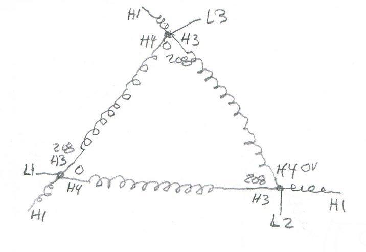

I have three of these laying around:
I've have 208V 3ph and I need 460V 3ph.
I initially thought I'd use use the 0V and the 208V taps daisy-chaining each H3 to the next transformer's H4. Supply 208 to each H3 and use the three H1s for 460V but on closer examination that seems more likely to get me 600V H1-H1-H1.
Suggestions?

You connection should work if you can live with 440 Volts instead of 460 volts.
You are ignoring the secondary windings and using the primaries as autotransformers.
Draw a delta with H4 and H3. Then extend each side to H1.
There is a phase shift. The amount of phase shift depends on the ratio of primary to secondary voltages of the auto-transformer connection. (The X1, X2, X3 secondary is not used and has no effect.)

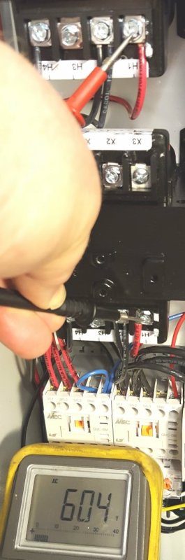

For some at-the-scene reporting!
These are 100VA control transformers.

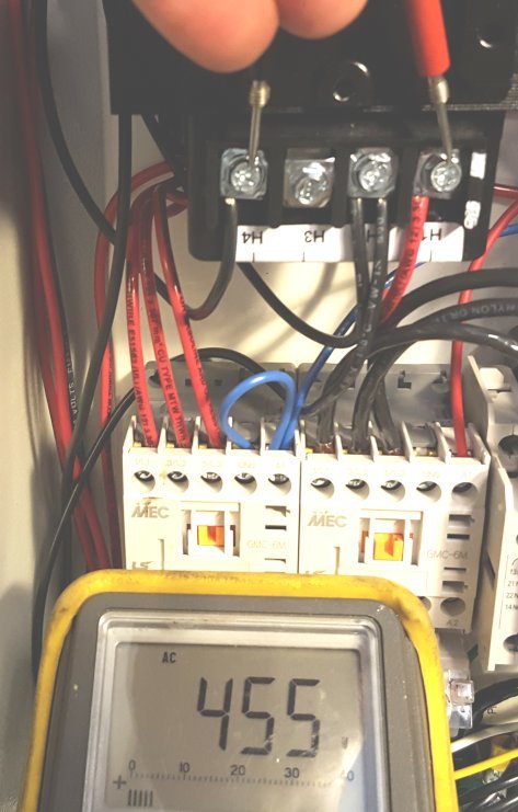

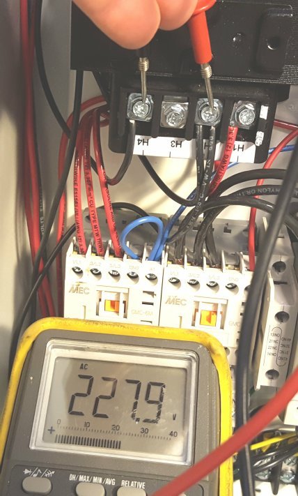

This is the voltage I've got to test with. Notice I'm using H4 and H2 (not 208V H3)
This is what we get across a single transformer wired up in our full 3 transformer delta scheme.
But, this is what is seen across the delta of the three H1 terminals between any two transformers.

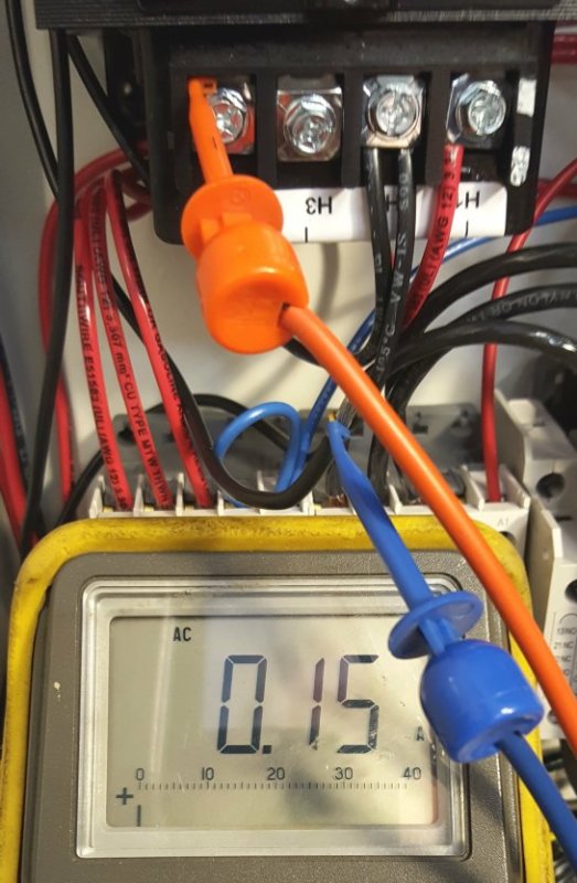

And another bit, is the current demanded by this "unloaded" micro bank of control transformers. .15A @ ~230V. Seems high but maybe not.

I think the 600V+ measured from H1 to H1 on the next phase is because you have a 120° phase shift and resultant sqrt(3) factor on the H1-H2 section of the winding between phases.
RE: Transformer schemes
Whoa 111R. So you're saying:
The extra winding between the 220 tap H2 and H1 the 440 tap, which happens to be 220V too, is contributing 220V x √3 = 381V
Adding 220 + 381 = 601V : (H2-H4) + (H1-H2)*√3 = 601V.
Did I get this right? If I did that's interesting news to me.

Draw a sketch and you will see that the voltages are as they should be.
Part of the problem is that your first hand drawn sketch is grossly not to scale.
You show H1, H3 as a little tag.
It is actually greater than H3, H4.
H3, H4 is 208 volts. H1, H3 is 232 Volts.
To make it simple use your present connections.
Then both the energized winding and the extension will both be 220 Volts.
Your 240 Volts delta seems to be only 227.9 Volts.
227.9 Volts x 2 = 455.8 Volts. Measured voltage = 455 Volts.
Pythagoras tells me that the voltage from H1 to H1 will be √7 x 227.9 Volts.
Measured = 604 Volts. Calculated = 602.97 Volts.
More tomorrow.

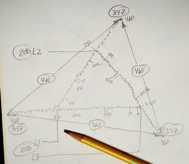

Your mention of 120V/115 in that screwy schematic had me hunt down the manufacturer's data sheet. This clarified that the the secondary was really 115V and the primary side is actually 208/230/460
Here's what works:
Auto-transformer using everything.
The secondary 115V winding is added to the bottom of the primary HV part of the transformer which is the first 230V half.
This gives 115 + 230 = 345 (input ratio)
Then this 345 has added the rest of the original primary which is another 230:
345 + 230 = 575 (output ratio)
Our turn-up ratio then is 575/345 = 1.67
Those are the hard winding ratios.
Now we supply merely 208V to the lower half and get the ratio'd result:
208V x 1.67 = 347.4V out of each transformer's H1.
Referring back to your handy √7 Pythagoras rule we see that 460 Volts, the ultimate delta voltage sought for, would be present with interim voltages:
460V/√7 = 173.86V which when doubled:
173.86V x 2 = 347.7V (All from your earlier post)
As for VA it seems roughly, 100VA/230V(transformed part) = 0.43A, needed: 0.25A.
Here's a better balanced diagram:
(NOTE: The circled values are actual applied/resulting voltages while the uncircled are winding ratios.)
