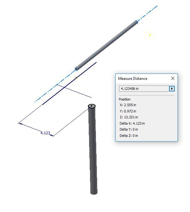

Here's a screen capture of my attempt to do this:
The two cylinders are not coplanar, and their axes do not intersect.
I created the sketch of the top cylinder first on the XY plane.
Then I created the second cylinder on the XZ plane, also projecting the face of the first cylinder onto it.
From this projection of the face of the first cylinder (a faint yellow line) I drew a new line, perpendicular to it, through its axis.
The dimension from this line to the center of the second circle controls the distance between the two cylinders' axes.
When the second circle is extruded into a cylinder, I can measure from axis to axis, and I get the result you see in the Measure dialog box: equal to the defining dimension on the sketch.
I notice that when I choose the "Select Other" item, I have to make another deliberate click on the "Axis" in the list for it to be selected. If you miss this click, it would explain your problem.

I understand your frustration now!
When I modeled the two cylinders, I modeled them in the same IPT as separate bodies. The two-axis measurement worked fine.
You have provided me with an assembly of two identical cylinders. Now the two-axis measurement fails.
I can even drag the ends of the work-axes around and get different measurements. It only measures to the tip of the axis, as drawn. Since the tip of the axis is arbitrary and cannot be constrained to any particular length, the measurement is completely uncontrollable. If I drag the axis ends long enough that they pass each other, only then does the Measure tool give a perpendicular-perpendicular distance.
So the answer seems to be "it depends". I can only congratulate you now, on finding a limitation in Autodesk Inventor's measure tool. I will be wary of it from now on!
