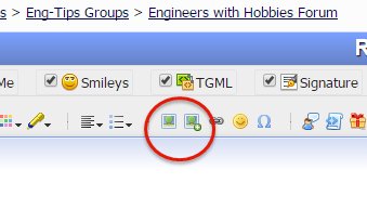

I will post some pictures of my 1952 Indian but have yet to figure out how to post pictures. So, how do I do this?
RE: My Indian Chief Restoration

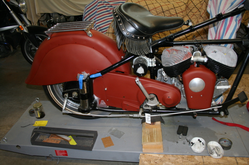

Thanks, IR. That seems simple enough. Image 1826 shows the primed sheet metal body pieces mounted to the bike for fit-up trials. That was the work I did over the winter. I got the finish painted pieces back in late May and image 1826 shows some of those pieces on the bike.

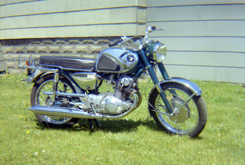

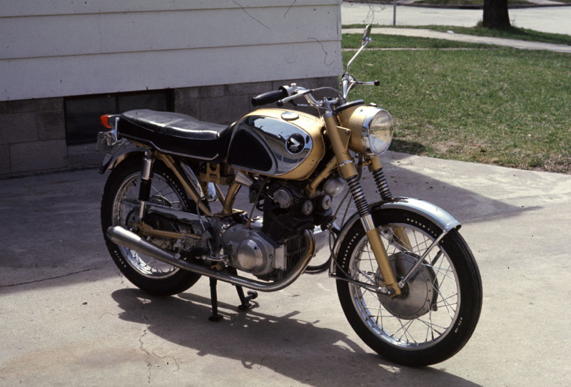

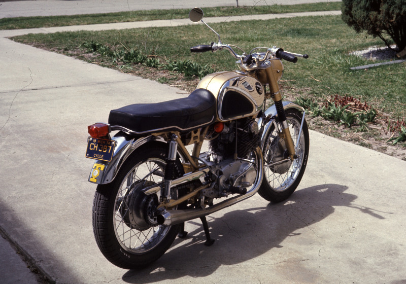

Back when I was younger I also rebuilt a couple of bikes, not perhaps as historical as your Indian (looking great BTW) but ones that I really liked at the time. The first was a 1964 Honda 305 'Superhawk' that I bought at the end of my Freshman year (1966) in college (I sold my Honda 150 'Dream' to my younger brother) from a guy going into the Peace Corp (it was his way to avoid the draft). During my Sophomore year, since there was nothing else to do during those long cold Michigan UP Winters, I decided to trick-out the engine and customize the outside. I worked for the dorm so I had access to various storerooms, one of which I 'converted' into a sort of 'bike shop' (which I shared with a couple of other riders) where I tore down my bike, repainted the frame, had the trim parts chromed and the engine bored out to 327cc. I also ported & polished the intake and exhaust ports, installed a racing cam and racing clutch. Except for the candy-apple blue paint job and the chrome plating, the exterior looked stock but it didn't drive like a stock 305. It would more than hold it's own with many of the larger 500cc Japanese and 650cc European bikes of the era.
Unfortunately I was forced to sell it in 1967 when I got married as I had no car and my future wife refused to consider the notion of going on our honeymoon on the back of a bike winky smile I eventually sold it it to my newly-minted brother-in-law.
Years later, after I graduated and had been working a couple years, I had a chance to buy a 1968 Honda 305 'Superhawk' that had been parked in some guys basement for about four years while his son was in the Army but then didn't want it after he got out. In this case, I left the engine stock (I didn't really trusted it as it had sat for those four years with no one starting it and even turning over the engine) but I tricked-out the exterior to make it look faster than it really was (I always wished I could have had that modified engine from my first 'Superhawk' in this second one's frame). Anyway, it was fun to drive as it looked great and I managed to drive it to work for a couple of years until, as I had worried, the main bearings failed and so I just scrapped it (this was in late 1975 or so).

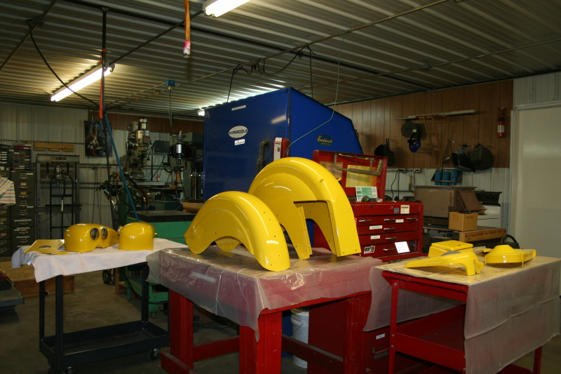

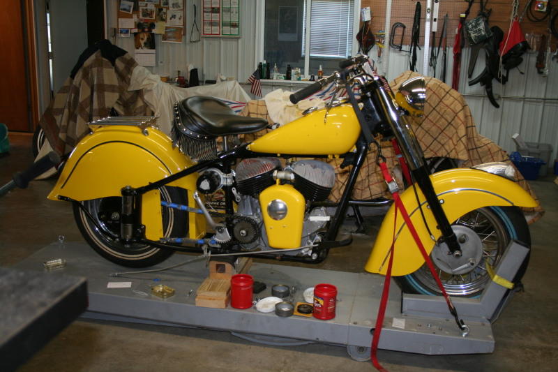

Here is a shot of all of the painted pieces just received from the painter. I don't have the fenders on the bike yet, as I am waiting on aluminum trim strips. Several vendors make these; the quality and fitment varies, as I have found out.
Nice workmanship swall. You have a very spacious home workshop too - I'm envious!

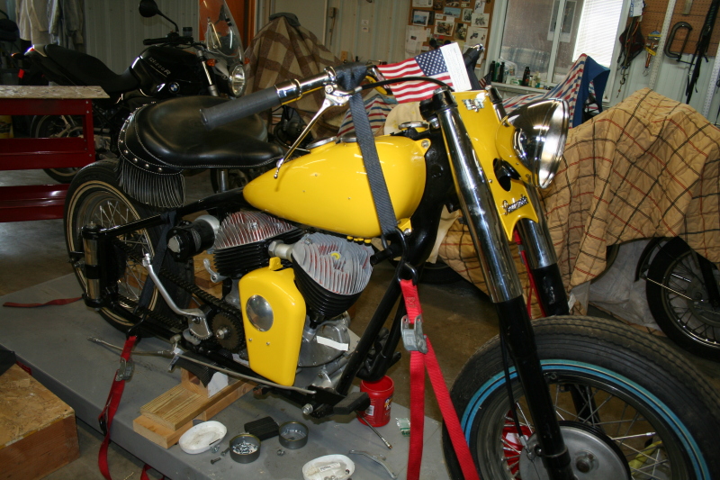

I got the fenders on--looks like a motorcycle now.I had quite a bit of delay due to finding repo fender trim strips that were any good.

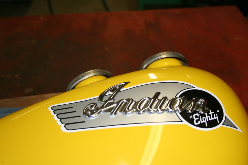

Got the "decals" and Indian script emblems on the tank.
Had trouble initially with the water slide decals I had purchased--the film developed cracks during the 90 second water soak. Plan B was to obtain adhesive backed transfers from another supplier and the installation came out fine. Final touches were applying the chrome plated brass "scrip" insignia. These attach via (3) 2-56 screws. In the run up to painting, lots of effort was expended to keep the tapped holes in the tank sides from plugging with body filler, primer and paint. I don't have the tanks back on yet--I am doing some fitment with the speedometer, ignition switch and wiring harness, all of which run between the tank halves
