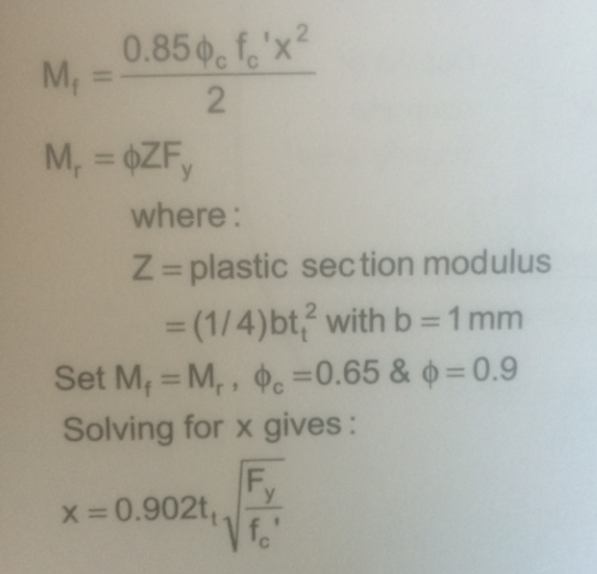

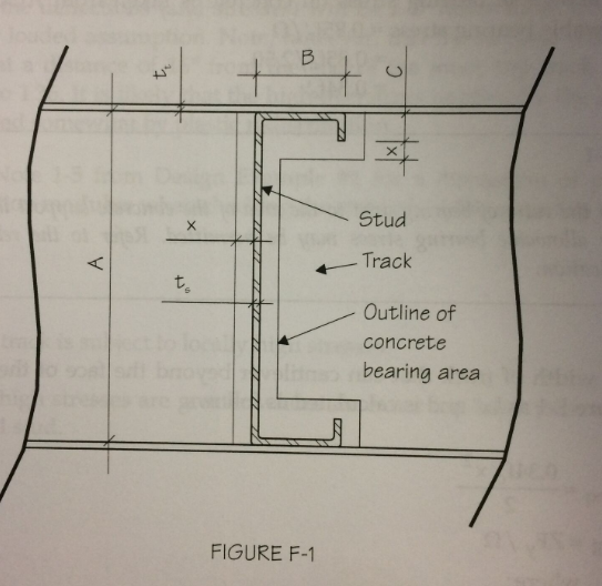

The procedure that I've encountered in the literature is as shown below. Probably similar to that paper that you cited.
There are some options but their viability very much depends on how may studs need to be addressed:
1) For a single stud pack, throw a steel base plate in there.
2) For a single stud pack, transfer to a clip angle (or a pair).
3) Beef up the gauge of your track and/or stud.
4) Put some thicker gauge strap below or inside the track.
5) use confined concrete f'c if appropriate.
6) put an HSS below your track.
7) reduce the stud spacing.

Last night I dug up the calc procedure that accompanies the diagram that I posted above. According to that, you can rely on the track acting as a base plate over a distance considerably greater than 45 degrees (more like 4X track thickness).
There is also some research confirming what others have mentioned above: it's more of an issue at concrete edges. Link
Some additional information on the design method: Link
And a journal article: Link

I think a good conclusion may be to rely on Trestain's method (the method you've pictured above) which after some number crunching appears to provide bearing strengths greater than the axial strength of the studs.... which is what we would expect!
Thank you everyone for your helpful comments.
