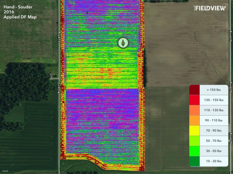

Thanks so much for the replies; I had been struggling to find any reliable information between the different valve types. The "zero leak" commutator style is very interesting and may very well go that way. Every LSHT motor around the farm is a Char-Lynn; I expected that the different manufacturers used the same designs. Nothing is commercially available to convert the drills, so DIY is my only option. I farm 1200 acres with my dad. Seed costs have grown considerably in the past 5-10 years, which has made it economically viable to move to automated control systems - to adjust population to soil types and clutch rows to prevent overlap and wasting seed. Couple of pics attached. Converted the planter to hydraulic downforce - every row has a weigh pin and cylinder to keep constant down pressure despite changing ground conditions. The map shows the force applied by the cylinders. The gradients across the field are from the change in seed box weight as they empty, the "U"s on the headlands are from the weight of the tractor slightly compacting the soil where we turn. Also installed electric drives on each row, so each population can be varied and clutched independently. Right at $20,000 all said and done for both. From someone that gets oily, thanks for what you all do, Casey
