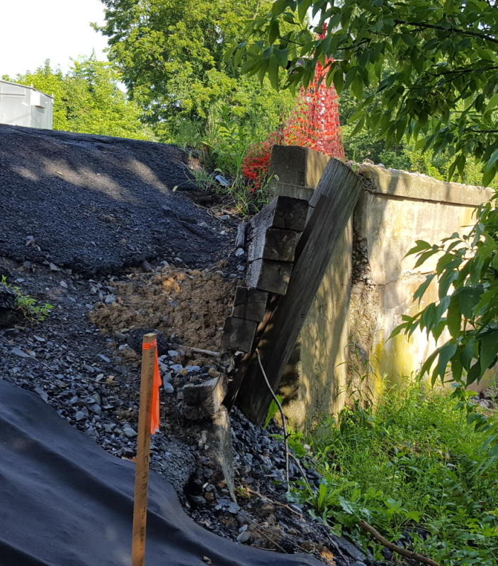

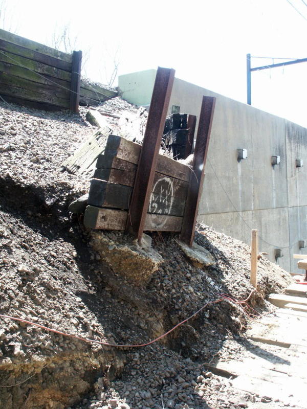

The only places I have seen railroad rails used as soldier beams for retaining walls has been along the side of track beds where the railroad maintenance workers apparently threw them into place as "Band-Aids" for areas with some erosion or where other, old, deteriorating, timber walls are failing. If you tried to design these "soldier beams," you most likely would find that they are too small, too narrow, and too short.
This photo does not show rails but, instead, shows small beams that aren't much different from rails. I don't believe that the wall in the photo can perform as needed, especially with Cooper E-80 railroad surcharge loading.

RE: railroad rail piling for embankment failures
Yep, looks familiar to me.
I have seen similar installations along county and state roads in rural areas. In many cases three are no timbers, or at least none left after who knows how many years. Don't have any pictures handy, but I'll post some if I can find them.
These types of "fixes" can work and sometimes work for many years. The factor of safety is likely just barely above 1, but it works until it doesn't anymore. Then you can always just add more pieces of rail and maybe it will start working again.
While I don't like this type of "fix", I understand why they are used by some agencies. Just don't ask me to design it.
PEinc.
Notice those section are set in concrete filled holes, possibly drilled with power pole auger.
Yes. The drilling surprised me because the "wall" is near the top of a high, 1.4H:1V, heavily wooded slope where drilling is not possible without shutting down the tracks. Railroads have one set of rules for us common folks and another for themselves.

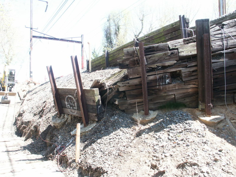

More photos of bad, soldier beam, RR walls.
