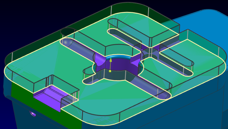

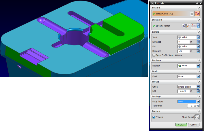

Hello,
I am attempting to create an extrude with single-sided offset but it is collapsing the face sometimes and only building one of the collapsed regions. Is there any way to force it to build all of the regions or switch which region it builds every time? See attached image for sample
NX 9.0.3.4 MP13

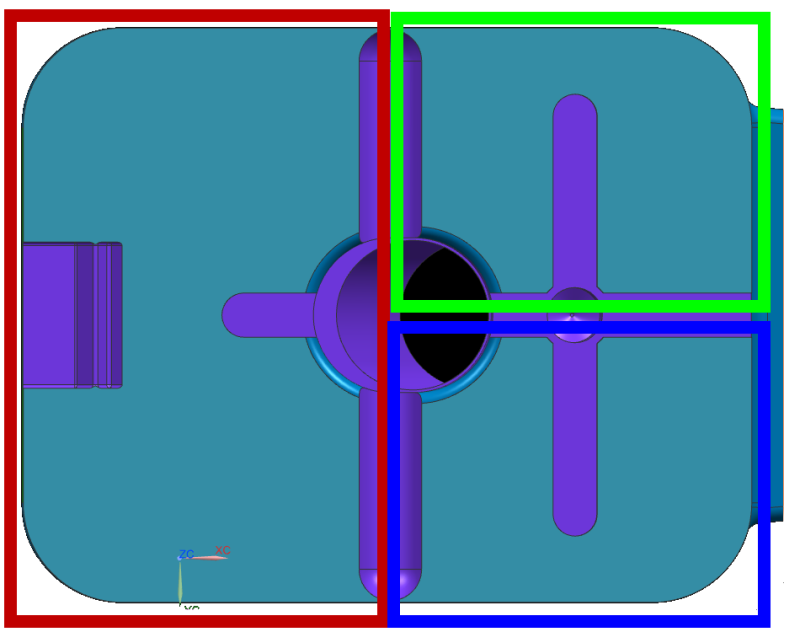

I'm thinking that ball-end slot nearest the middle of this "pad" area is too close to the outer perimeter for the offset to work in all 3 areas that you're expecting to appear in the preview. Try selecting the curves such that it's not everything at once. The 2 areas that appear to be mirrored might be able to be done all at once, but that left-most area will have to be done separately.
See the attached image for what I'd try - might have to be 2 Extrudes (the right-most areas with blue outline & then left-most in red.

I am using the Face selection intent to select all the edges of the face highlighted below:

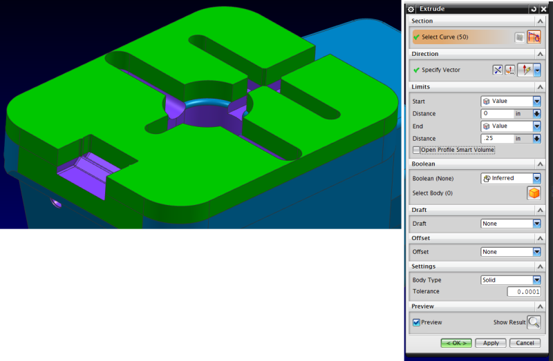

If I do a regular extrude normal to the face, and without any offset, here is the result.2. No offset example.png

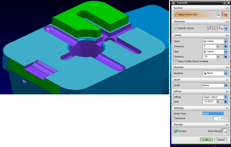

When I start putting in a negative single sided offset, the offset causes the edges around the ball end slot to collapse on the edges going on the outer perimeter of the face. This collapses the offset and instead having multiple extrude bodies as results, it only chooses one region.
When I increase the offset, the region changes for some reason.
This is the result that I would like, for all 3 regions to be extruded:
