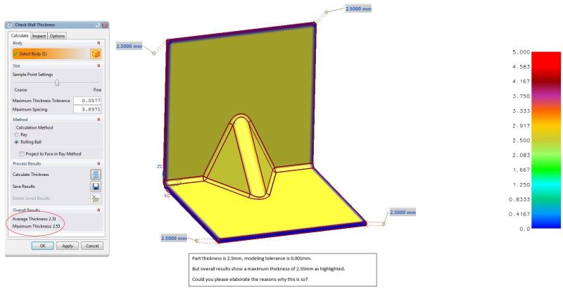

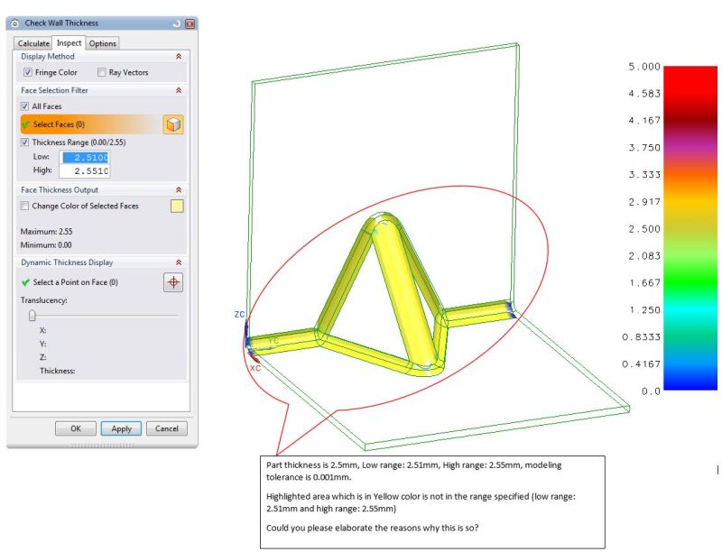

I have couple of query about Nx wall thickness check command.
1.
2.
I have uploaded the NX part file which i have used for wall thickness analysis.
http://files.engineering.com/getfile.aspx?folder=1...
Requesting you to go through above queries and let me know your valuable comments.
Thanks in advance,
Regards,
Sreeram

Hi I would suggest reading the documentation for the wall thickness tool.
1)
* Modeling tolerance will not have any noticeable effect on the wall thickness tool.
* The radii deviation is due to tesselation difference between the surfaces, this become evident if you use a finer tolerance, rolling ball spacing, and adjust color fringes, see image below.
In comparison thickness calculated in GOM Inspect Pro
2) Read the documentation of how rolling ball works
