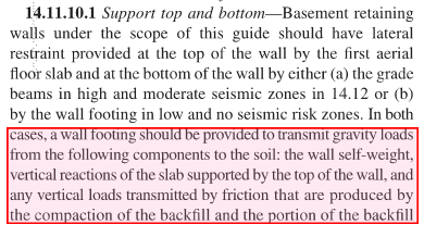

1) See the blurb from ACI314 below. It's not quite explicit in endorsing the pin-pin method but, in my opinion, is headed in the same direction.
2) Detailing varies but the most common version in practice seems to be interior face wall reinforcing and matching, interior face footing dowels. Exactly the opposite of what you'd do if you were wanting to transfer moment through the joint. I take that as evidence that the majority of Romans are doing pin-pin.
3) You rarely see top steel in the strip footings as you might expect if you were planning on transferring moment to the footing (non-eccentric footing). Again, I take this as an indicator of what the Romans have been up to.

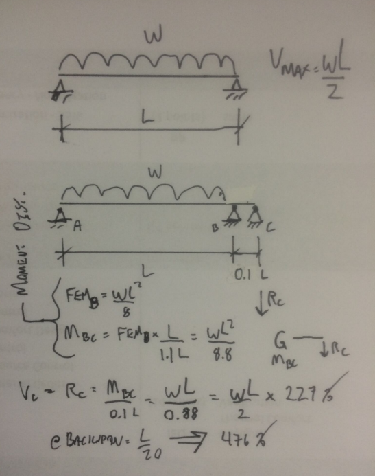

RE: Retaining Wall Footings (For the Fourth!) - Fixed or Pinned Base
Triangular stress distribution is where I think the difference in your two FBDs comes in. Koot's assumes triangular ( I actually think I see a curved shear diagram between the main floor and the slab, he's one to use a straight edge, or straightish at least, if it were a rectangular stress distribution)
I don't that fundamentally alters the problem though. Imagine you have a beam supported at both ends, and you add a new support some distance x from the other supports. I don't think there is a situation where this can increase your shear, you aren't adding load. Koots sketch looks like load applied to a cantilievered portion of beam. I can see the logic - you take a beam cantilevering some distance from two supports, the shear diagram looks much like that. You add a support at the top though and the two supports at the bottom are no longer required to be a couple to satisfy statics.

Exactly as Jayrod explained it. I guess that, technically, there should have been a slight curve to the "big shear" part of the diagram as well but that is of little consequence.
@Canwest: try this in your head (or in SAP) and let me know if it doesn't check out:
1) Start with a 10' beam fixed at the left and pinned at the right.
2) Apply a uniform load of any intensity.
3) Instead of conventional fixity at the left end, extend the beam 6" to the left and provide another pinned support there. All three supports are now pinned.
4) Review your moment and shear diagrams. The original span diagrams should remain essentially unchanged. Shear should skyrocket over the 6" extension.

Quote (KootK)
Are you interested in any in-print stuff that suggests pin-pin? I'm happy to go digging in my collection but I don't want to expend the effort if you're only interested in the theoretical aspect of this. Even if I can find published examples of pin-pin, I very much doubt that they'll go into the kind of theoretical detail that we've been discussing here.
Sure, but don't spend more than 5 mins on it. A suggestion of a good foundation reference book would likely suffice. The references I have to date have sufficed to date, but the current project I'm working on requires a bit more involvement.

In seven foundations books, I found several examples of basement walls designed as pin-pin but not a single example of the footing being addressed in concert with the wall. Utterly inconclusive.
Quote (KootK)
Haha, no big surprise there. If anything, this thread has convinced me that we don't really know the true behavior, but be consistent in your design assumptions.

It's all about the span:backspan ratio which is why I recommended 20:1 above for the experiment. As the space between the two supports representing fixity tends to zero, the shear in the back span tends to infinity.
To an extent, you can think of an analogous cantilever having a cant span matching the distance to the inflection point in the real span. You'd need the fictitious cantilever distance to be several multiples of the backspan before you'd see critical shears in the back span. In your example that ratio appears to be only about two.
I understand where you're coming from and it holds true for cantilever with two pins and a small backspan, and to a lesser extent to a cantilever with one pin and one fix support on the backspan, but that is substantially different to what is happening here, as there is no cantilever. As a thought experiment, look at the second shear diagram posted. How will adding a support at any point increase the shear?
FWIW, the first example had a 5:1 ratio. I've bimped it to 50:1, and the shear is now around 23 kips for the same load. As the pin approaches the fixed support this value will eventually reach the ~27 kip that we saw when the pin wasn't there.

I did a little moment distribution in order to validate my position. At at backspan of L/10, I get a 227% increase in shear over the base case. At L/20, it goes to 476%. Granted, attempting hand calcs is a pretty reliable way to embarrass oneself. I await the onslaught.
I need a lot more time to digest this. In FEA the results are what I'd expect, a reduction in shear of ~10% for the case you show, then I use the method of superposition and get an increase of 220%.
