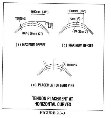

Is there anybody who knows which code explains about minimum Radius on a curvature tendon? Is there any formula/calculation method for this minimum radius? And if the Prestressed Tendon Curvature follows the minimum radius, does that mean Hairpin Reinforcements become unnecessary? Thank you.

Your question about hairpins is far too general to answer. I would not think that hairpins would overcome the concrete crushing and bursting problems that you get from too tight curvature. Or the duct wear or higher friction. So I would assume that they are there for another reason.

@rapt: What do you mean? Isn't the hairpin used to bear the lateral force due to the curvature? For bursting, I think we use Bursting Reinforcement.
RE: Urgent - Prestressed Tendon Curvature Minimum Radius
I doubt that the hairpin would develop much stress before the concrete was in trouble due to high compression stress. It may stop a failure but it will not reduce the compression stress significantly in my opinion.
Hairpins might work to stop breakout/spalling where an angle change is near a surface and towards the surface as happens at kinks in tendons near anchorages in large bridges etc. In a general area where it is concrete crushing that is the problem, I doubt that they would alleviate the problem as the concrete would have to crush before they were fully activated.
