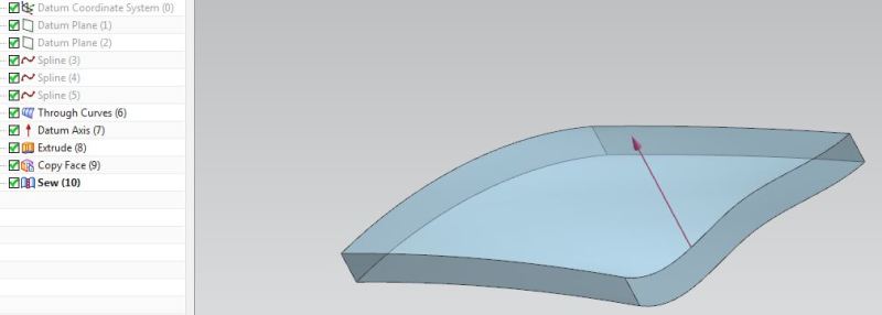

You're able to thick a surface via Extrude it boundary curves along any vector. Is the picture shows what you need?
1. The Datum Axis defines a Die Vector
2. Make an Extrude with outermost boundaries along the vector. The result would be a Sheet Body
3. Then copy top face along the Die Vector in order to "cover" the Sheet Body from the bottom
4. Sew both Copied Face and Sheet Body
5. The result should be a Solid

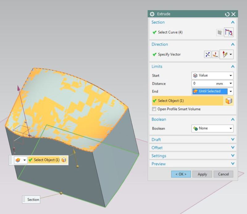

The other way is to use an Extrude limits instead of Trim body:
After you made a boundary projection onto a plane along a die vector - extrude it with end limit set to Until selected:
Also try to use the Emboss Body feature, it would also helps.

Instead of “Until Selected”, if you use “Until Extended” option, the trimming face (a single face = plane) could be anywhere and smaller than the extruding boundary.
In an assembly environment, you could use Until Selected/Extended to an external object’s Plane/face/surface with the option of automatically creating Interpart Link (Associative/non- associative).
Optionally to trim face and also when the surface (larger than the extrusion) isn’t intersecting the extrusion, you could use Sync Modelling's Replace Face.
