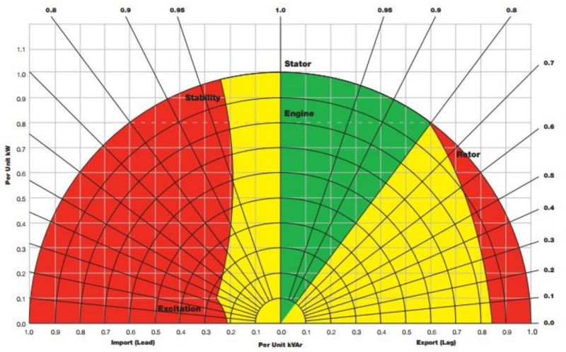

My reply : What you said is very generic , to be more precise , generator capability curve and generator damage curve should be referred to know as to in
what conditions the generator can work , and in which it cannot ?

My reply : Correct , but as I said better to look in generator capability curve as it will tell you the rating of Prime Mover and you will come to know
if your engine is over sized or not .
Example Capability Curve attached below

Capability curves are interesting and in some cases colourful. But what what are they based on?

Thats true I2R , and this info is provided by the generator vendor in the form of generator damage curve .

Ok , but why dont you say to check the capabilty curve for all this limitations .
They are based on
(1)Stator Copper Loss (stator heating):
The maximum allowable heating of the stator sets a maximum
phase current
IA for the machine. It’s equivalent to set a maximum
apparent power for the machine. (Power factor is irrelevant.)
(2) Rotor Copper Loss (rotor heating):
The maximum allowable heating of the rotor sets a maximum
field current
IF for the machine. It’s equivalent to set a maximum
EA for the machine.
(3) Prime-mover’s Power Limit.
Well, a prime rated set will actually be a larger set, derated.
A 2500 KVA prime rated set will actually be a 2750 KVA set. Get the basic capability curve for the 2750 KVA set and look at the capability of a 2500 KVA set inside that curve.
Using the same set as a prime rated, 416 Volt set? Look at the capability of that 2170 KVA set inside the capability curve of a 2750 KVA set.
But what does it matter? A bolted fault is so far outside any capability curve that discussion of capabilities becomes moot.
You are right , generator capability was mentioned , because since limitations of alternator were getting discussed , so capability curve became essential.
Offcourse , gen capabilty curve is not helpful in knowing the machine behaviour while a short circuit bolted fault occurs

A comment on capability curves: For large alternators, particularly paralleled generators, capability curves are a must and protection to prevent operation outside of the curves is a must.
For smaller diesel generators operated islanded it is unusual to see a capability curve. I admit that if you are in the habit of demanding capability curves your regular suppliers will readily supply them, but I have spec'ed a lot of diesel generators, installed a lot more and checked the published specs for even more without seeing an easily accessible capability curve. We use nameplate data and basic published data but we are aware that unusual loads may need a second look.
It would take something like a combination of an unusually low power factor load demanding the full KVA capability of the alternator to put the alternator outside the PU capability curve.
In the real world;
Such loads are rare.
The PU capability curve is valid for only one or two applications. For operation at reduced KVA rating or reduced voltage, the capability in the lagging PF region is extended somewhat proportionally.
I admit that if you are designing parallel generator applications, some extra protection may be prudent.
Again, in practice, protecting against over-fluxing and under-fluxing by the AVR may be all that is required. In some cases the basic protection afforded by the AVR may be adequate.
If you are using a generic capability curve it may not be applicable to all possible ratings of the set without adjustment.
In the real world;
Even with smaller diesel sets, in parallel operation, a malfunctioning AVR and or an inappropriate throttle setting may result in damage due to operation outside the capability curve.
