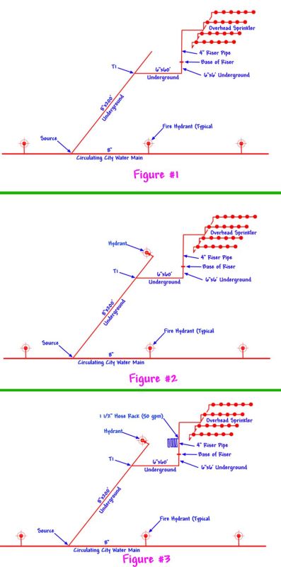

Consider the following three figures:
In Figure #1 you would calculate the overhead sprinkler and carry that water all the way to the source where you would then add your hose stream. If the system were OH-2 requiring 374.6 gpm at the base of the riser then you would flow 374.6 gpm through both the 6" and 8" underground finally adding 250 gpm hose at the source connection.
In Figure #2 you would add your hose stream at reference point T1. Assume OH-2 again requiring 374.6 gpm you would flow 374.6 gpm to reference point T1 where you would add 250 gpm for hose stream for a total water demand of 624.6 gpm. From reference point T1 to the Source you would flow 624.6 gpm.
In Figure #3 we have an ancient and out of date 1 1/2" hose rack unit for occupant use. Assume again OH-2 where the overhead demand was 374.6 gpm you would add 50.0 gpm at the point where the hose rack tied into the system for a total of 424.6 gpm carrying that out to reference point T1 where you would add 200 gpm more for the combined inside and outside hose stream demand of 250 gpm. From reference point T1 you would calculate the head loss flowing 624.6 gpm to the source.
Adding hose streams seldom, I say seldom because I never use the word "never", has anything to do with pressures other than adding head loss through the underground.

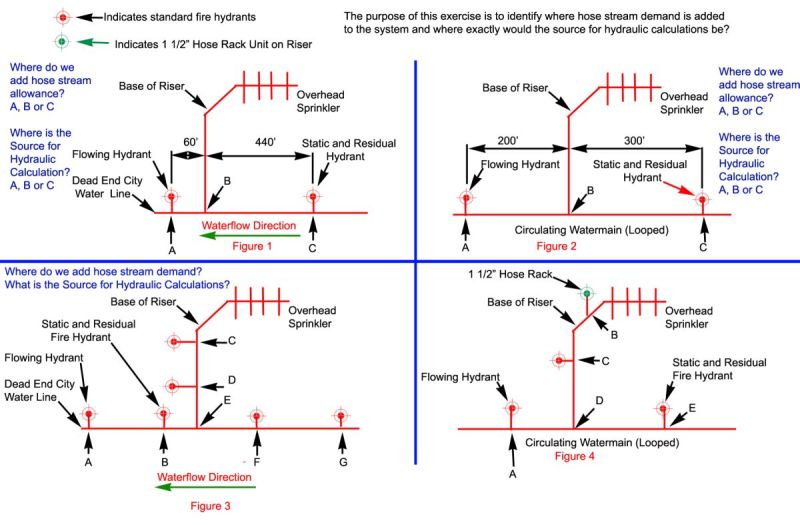

RE: Add more water volumen to a fire sprinklers system.
Over the years a good number of beginning students had difficulty in figuring out where hose streams should be added and where is the source.
In the four examples below where would we add the hose stream demand if we were dealing with an OH-2 Occupancy?
In addition to hose stream exactly where is the source in each of the following figures?
