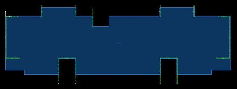

I've been looking into setting up a few spreadsheets to aid my lateral design sanity calculations. I've come across something that is racking my brain...
My spreadsheet is based upon textbook methods of setting up tables to resolve normal forces and torsional moments into shear forces in each wall. Textbook Example Extract
A quick layout of the problem at hand is shown below.
My question: is it conservative or unconservative to perform this method of shear wall distribution with all walls to be considered as isolated and NOT grouped core walls?

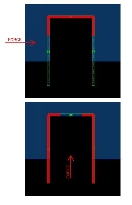

Load is attracted to stiffness and we distribute our horizontal shears based on stiffness. Now if I distribute this shear based upon individual walls only and NOT grouped core walls, I may be underestimating the amount of shear carried by the C shaped core's web if the force was acting in the X direction, as the combined stiffness of the C shaped core will be much more than just the web alone, even though the shear will be resisted in the web only.
Then throwing in the notion of effective flange widths, which complicates matters even more. I would then have different stiffness and core centroids due to the 'effective' core properties for each direction of load.
I'm having trouble piecing this all together! Any help would be much appreciated.

It sounds as though you understand the issues perfectly Trenno. When the composite nature of composite wall assemblies is ignored, the distribution of load to the various walls will be altered. This may produce either conservative or unconservative results for various walls, diaphragms, and foundations.

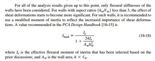

In the that SS Ray's textbook example, I can see they are computing shear area, however I've not come across a global analysis method that takes this into account, usually it's just based on flexural stiffness (eg Ix or Iy).
In any case I don't think I should be trying to input 'effective' core properties into my spreadsheet as it will make it more complex, but on the other I don't see how long flanges results in more shear being attracted to those South C shaped stair cores?
Not sure I agree. You're implicitly incorporating shear flexibility if:
1) You're using Etabs, RAM, etc.
2) You're using the "stiffness varies with length times width" assumption that is common for low rise masonry and concrete buildings.
Quote (Trenno)
Right. I think the trick here is to incorporate shear stiffness into your spreadsheet such that the numbers will produce a result consistent with your apt intuition. The method below appears in MacGregor's text and is taken from a PCI publication.
For the building under consideration here, I'd recommend just treating all of the wall groups as disconnected rather than composite assemblies. That should be quite accurate given the probable wall aspect ratios that you're dealing with.
