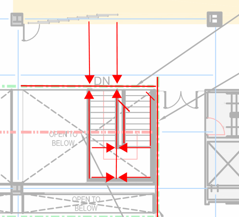

Having dealt with issues related to floating monumental stairs before, I thought I'd look into your question as well as overall scope of this stair.
First, are you are framing it like this?
As for torsion / weak bending, the existing W21 shouldn't get either if you run the stringer backspans through it. Given how close your new header is to the existing W21, I'd consider having them shore the W21, cut it at the new stringer backspans, and then re-connect it to the stringer backspans. Sounds counter-intuitive, but it permits a better stringer backspan and avoids six moment/torsion connections through the web. Also addresses your OP question by eliminating the question or torsion altogether.
You can learn a lot about monumental stairs via modeling in Elements and toggling the support fixities. Doesn't replace learning it yourself, but sure helps speed up the process. Your concrete slab should be able to take any lateral thrust, but this is where toggling can help you verify that.
Overall, deflection of your landing is the biggest concern.
You'll want to consider construction sequence, cambering, tread material, etc. My suggested framing plan forces contractor to erect the lower flight last, which can also help your deflection challenges.
Last point---never hurts to add up the steel tonnage/$ savings if you were to add a single round post at the center of the landing. Back-pocket negotiation.

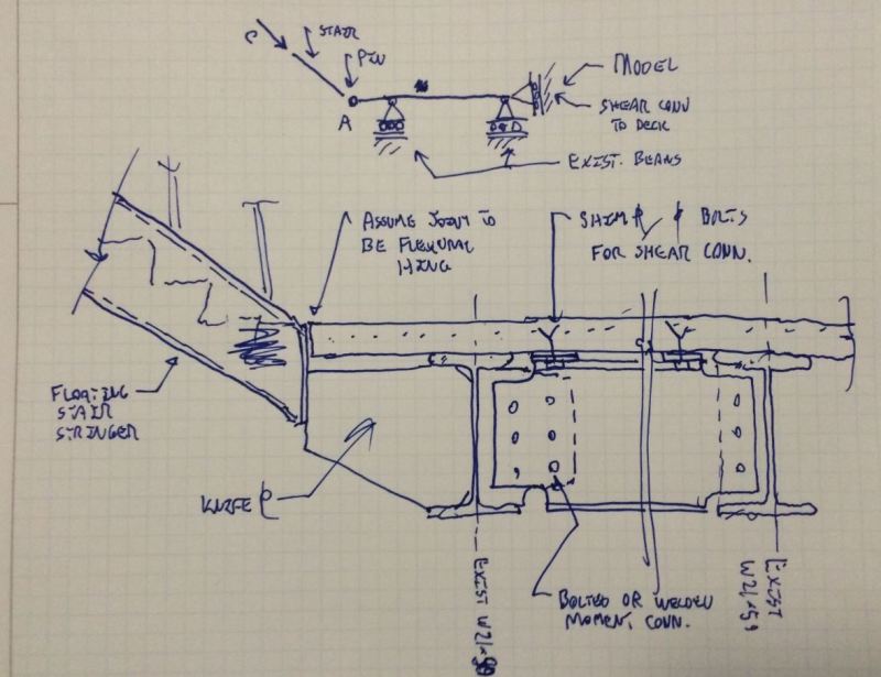

Regardless of what detailing you go with, I'd recommend modelling the connection at the bottom of the stringers (point A in my sketch) as a flexural hinge. Three reasons for this:
1) As you're finding out, dealing with all that torsion (lateral moments) is tough and;
2) Even if you successfully deal with the torsion, the supporting beam will be very flexible with regard to twist and, therefore, likely not behave as you've modeled it.
3) The dominant behavior for these kinds of stairs tends to be axial load in the stringers being resisted by the axially stiff floor slabs. Modelling and designing your system to suit this mechanism will likely be the path of least resistance and best performance.
Without knowing anything about your particular string/slab detailing, I've sketched a possible detail that I think would work well here. There would be no appreciable torsion in the W21x50. All of the reactions would really be springs of sorts of course as there is flexibility in all things, particularly the beams.
Often times, demolishing some of the slab is the only way to keep the transition detail clean.
