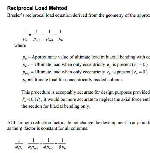

No need to stress. Squarish concrete/masonry columns that work for uniaxial bending are almost never critical for biaxial bending. Your flexural lever arm across the diagonal increases for biaxial bending and that tends to trump everything else. Google Bressler's method for a quick and dirty.

It is. By the book you'd do a strain compatibility analysis just like you'd do with a concrete column.

I remember doing that method in my Masonry Class. The senior engineer I work with, however, once recommended the P/A + M/Sx + M/Sy method.
Not to challenge you, but out of curiousity, what is incorrect about the latter method? Doesn't take into account slenderness, or tension only resisted by reinforcing?
RE: Biaxial-Bending on a Masonry Pier
Quote (cal91)
Challenge away. I live for technical debate.
Quote (cal91)
Doesn't take into account...tension only resisted by reinforcing?
Exactly this. At least in general, If the column doesn't actually crack, M/Sx starts to look a whole lot better.
