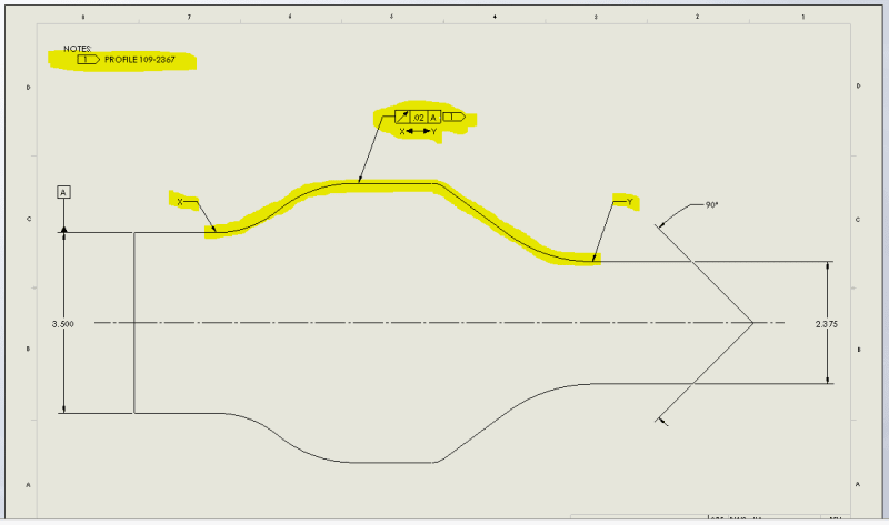

Is there an acceptable practice to control runout (axial location) of a feature-set separately from the form of the feature-set (which is controlled on another print)?
On this print, essentially, what I want to convey is:
THE FORM OF ALL FEATURES FROM POINT X TO POINT Y IS CONTROLLED BY PRINT 109-2367
THE LOCATION OF ALL FEATURES FROM POINT X TO POINT Y IS CONTROLLED BY THE RUNOUT TOLERANCE ON THIS PRINT
Here's what I came up with - I just wanted to get some feedback on whether or not the intent is clear, and if you think this is an acceptable depiction of the requirements as described.
*Our drafting standard for the most part adheres to ASME requirements - Y14.5M-2009, Y14.100 (*our flags are special...), etc.
The background:
I have two prints: a machined part print, and a print which describes a modular feature-set used on the machined part.
This common feature-set (colloquially known as "the profile") is used on multiple parts.
Since each profile feature-set may be used on 1,000's of prints, we keep all dimensions relating to the profiles on their own prints for purposes of maintenance and consistency.
The profile print itself controls the form of the profile feature-set (profile of a surface tolerance of .002").
This is inspected using a contour tracer, which historically has worked very well and I'm told is within an acceptable limit for capability.
The profile has a tight tolerance because it has to fit with a mating part, however the location of the profile feature-set is determined ad-hoc for each application.
For this application, we want to control the runout of the profile in relation to another feature of the part. The entire profile can be allowed to runout by up to .020" and the assembly will function as intended.

I suggest you explain your intent on the face of the drawing in form of a verbal note, exactly the way you explained it to us:
"THE FORM OF ALL FEATURES FROM POINT X TO POINT Y IS CONTROLLED BY PRINT 109-2367
THE LOCATION OF ALL FEATURES FROM POINT X TO POINT Y IS CONTROLLED BY THE RUNOUT TOLERANCE ON THIS PRINT"

The approach you described makes sense, however...:
1. The profile of a surface tolerance of .002 specified on the profile print does not only control form, but also size of the profile, thus you may want to modify first part of your note accordingly.
2. I assume the print you showed us is intentionally incomplete, and that there is something on that print that controls location of the profile along the axis of the feature. If not, I think you may want to consider use of profile tolerance instead of circular runout, as the circular runout does not locate the profile axially.

To clarify, is "the profile" (X <--> Y) a surface of revolution? You're using a circular runout tolerance, but your drawing doesn't have diameter symbols on the 3.500 or 2.375 dimensions.
Could you show us "PRINT 109-2367", or at least the relevant portions of it? The actual dimension and tolerance values aren't important, but the general scheme and the notes might be.

I greatly appreciate the input. I like the idea of supplementing the depiction with the notes, so I will add that.
To answer some questions:
The example shown is just a representation to describe the situation, not the actual drawing I'm working with - the actual drawing, and the profile, are proprietary designs that I cannot share. The profile drawings have all the basic dimensions and a profile tolerance from x to y - that's about it.
Yes, from x to y (the profile) is a surface of revolution. Missing diameter symbols are a result of a hasty draft to serve as analog for the real print (see answer above) :)
Yes the profile is intended to control both form and size.
As far as profile being used to control form independent of size, I think ASME Y14.5 (2009) is pretty clear that it can be used that way.
For example, in 8.2 the distinction between controlling form and controlling a combination of form, size, orientation, location is clearly made:
In 8.4.2, again a very clear distinction is made between the use of profile to control form independently, or to control a combination of form, size, etc.
And then we have clear examples showing profile controlling form, with size controlled through a ± tolerance:
And profile controlling both form and size together:

Well, if the diameter of the "profile" on the profile print is dimensioned with +/- tolerance, or there is no diameter dimension and a "radial" height of the profile height is given as basic dimension (could you confirm, cbrf23?), then I say the profile of surface tolerance controls form only sad
If the diameter is basic, the profile of a surface tolerance controls size and form.
I am still missing one more answer from cbrf23. What controls location of the profile between points x and y on the print of the entire part?

If the profile is fully defined with basic dimensions (including diameter) on the profile print, then to control its axial location you could replace the circular runout tolerance with profile of a surface. You would need to change the datum feature references to include an appropriate feature, and add a basic dimension from the profile to that feature. Your flag note could read "SEE PRINT 109-2367 FOR BASIC DIMENSIONS AND ADDITIONAL TOLERANCES" or similar. I don't think the note would need to explain the goal of each print; the tolerances should speak for themselves.
While it is true that the profile tolerance in ASME Y14.5-2009 Fig. 8-17 does not control size, that is only because there is no such thing as size for a conical surface in isolation. A cone is fully defined by included angle alone. Size is only meaningful for a cone in relation to something else. The profile tolerance has no datum feature references, so that is not the case here.

For a complex shape like the one in question, I'm not sure there's a meaningful or well-defined distinction between "form" and "size". Do you mean that the lack of a basic diameter dimension would allow the profile of a surface tolerance zone to uniformly expand or contract radially?

Yes, that is basically what I mean.
Even if that is not the case here, it is possible to imagine that the profile print fully defines FORM the contour between points X and Y by giving all necessary basic dimensions on one side of the axis only. In that case additional +/- diameter dimension will be nothing but a separate SIZE control, and, like you said, the profile of a surface tolerance zone will be allowed to uniformly expand or contract radially.
This concept has been covered/clarified in the draft of new Y14.5? Figures 8-17 and 8-18 from 2009 version have been modified and now they do not have +/- diameter dimensions at all. Basic diameters have been used instead, extra profile callouts replacing +/-0.2 size tolerances have been added, and the 0.02 profile callouts have been changed to dynamic profile tolerances - callouts that define tolerance zones that are allowed to uniformly expand or contract radially within the larger profile tolerance zones. These new figures in the draft still need to be improved, but their intent is quite clear, at least in my opinion.
