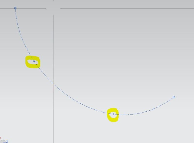

I am a little challenged in my layerorganizer journal (VB.Net)...
I'm almost done with this tool - a lot of object types and subtypes, layer range and much more fun can be controlled..
But -
I'm trying to collect the points that are placed on a spline path - within the Mechanical Routing application in NX.
But it seems like these points are just NXOpen.Point.....But I need to be able to collect only the points (from a routing splinepath)..
In the SplineSegment Class I cant fin anything that will let me ask for these points---of course I could have missed something.
Maybe someone here on Eng-Tips have being playing with this earlier -or maybe just someone can guide me in the direction of success.
