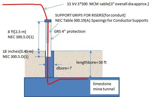

I have been given the task of installing 15kV power via a 50 ft long borehole, six inches in diameter, from the surface down into an underground limestone mine. The power cable down the borehole is estimated to be a 500 MCM three-conductor cable plus ground. I have never installed a borehole cable nor have I ever seen it done. I am looking for any technical help and advice anyone can give. Some questions I have are:

Thanks for your advice. I haven't gotten into this far enough to make a beer napkin or whiteboard engineering drawing yet. I was thinking that since the total suspended length of the cable will be around 85 ft, I could use a single 4 ft long chinese finger cable grip to support the cable at the surface. In addition to the chinese finger grip, the cable would emerge out of the borehole at the surface and travel vertically to a fixed 'D'-Ring where it would wrap around the D-Ring (and be clamped to it) down to a small horizontal cable tray. From there it would travel along the cable tray a few feet over to the utility pole where it would then radius upward and go up the pole to the cable terminators at the top of the pole. I hope that explanation was clear in the absence of a sketch. If you or anyone have any other ideas or suggestions I would certainly appreciate hearing about them.

In my opinion, it is about a cable run as in attached sketch. It could be?
